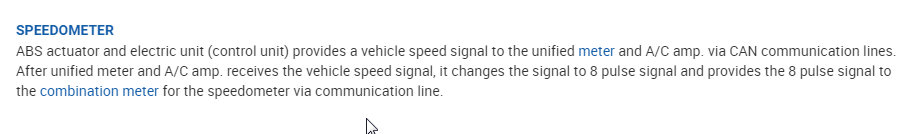

Okay. So if you replaced the speed sensors because you had a code, can you give me the codes that you had or have?
Take a look at the attachment. This is the reason I wanted to clarify what the issue was. The speed sensors give the data to the ABS control unit and then it shares the info to the cluster/combination meter over what is called a CAN bus network. This means either the ABS is not getting the speed sensor data (which is why I need the codes) or the ABS is not sharing the info with the cluster or it is not able to because there is a wiring issue.

Oh. Well that answers it. Yes. This is a speed sensor code and yes, that can cause the speedometer to not work. You have two and if the ECM sees they are not the same then it sets this code and if you are not getting speed sensor inputs then the ABS can't send the signal to the cluster for the speedometer.
We need to fix that sensor and then retest.

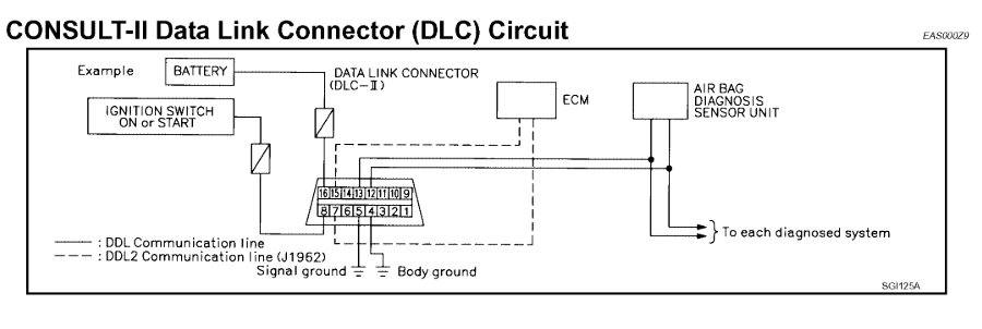

Do you think that can be the problem why the scanner can't communicate with the computer of the car as well?
Oct 13, 2019 at 1:40 PM
Can your scanner communicate with any module or just not the ABS? Then have you been able to communicate with the ABS in the past?
A lot of scanners cannot communicate with ABS modules so that may be normal.
This could be a sign of a greater issue but again, the sensor needs to be the first thing then if the scanner is still an issue we can dig into that but I would think the sensor will fix the speedometer issue. In other words, I suspect you have two issues if the scanner can communicate with ABS modules.
Oct 14, 2019 at 5:24 PM
KINGR30
  • 21 POSTS
It does not communicate at all.
Oct 14, 2019 at 5:51 PM
Okay. I assume the sensor will fix the speedometer. Once we get that repaired we can move onto the possible DLC issue or module issue. However, if the speedometer issue is fixed then we will need to start a new post for this issue because we need to keep one per post. People can't find solutions for their issue if they have the same one if it is under a different post.
However, here is a diagram of the DLC. We need to check and make sure you have 12 volts with the key on on pin 16 of the DLC. Then ground on 4 and 5. Then you should have continuity from the DLC to ECM on Pin 7 and 15. If any of these are not correct then you will not be able to communicate with the vehicle. Also, just a dumb question but has this scan tool ever communicated with this vehicle before? I just want to make sure it is not a scan tool issue. If it has, just check it on another car to make sure the tool itself hasn't failed. Seeing if it communicates with another vehicle is the easiest way to do that.
