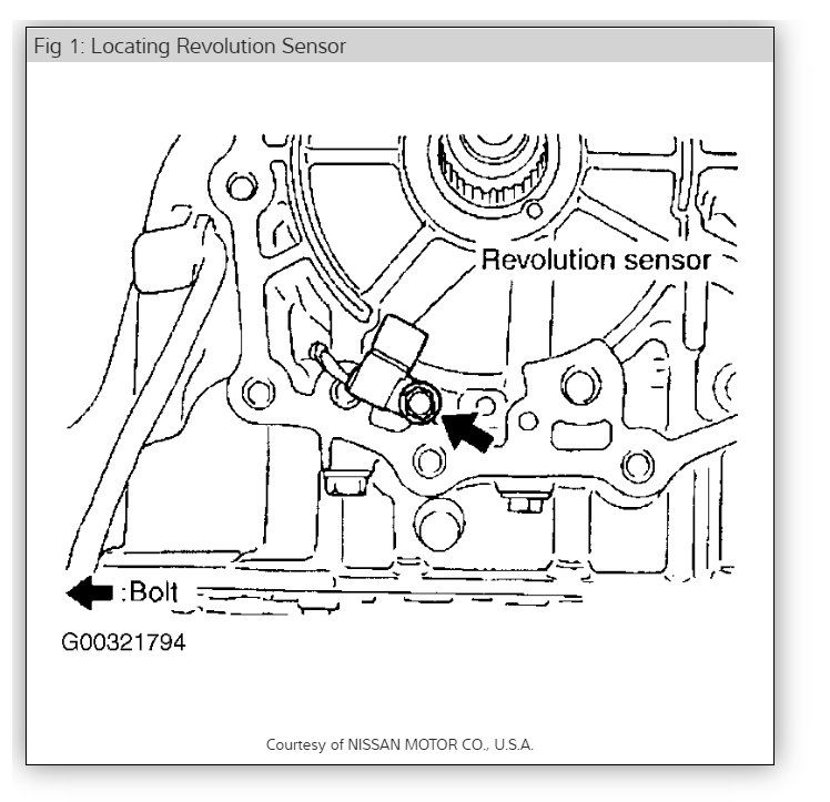

Location of vehicle speed sensor is unknown and would like help finding it please and thank you.

They call it a revolution sensor which is inside the bellhousing, pretty convenient right? Check out the diagrams (below). Please let us know what happens.
