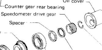

I attached a picture of the drive gear. If the gear on the cable is good when you remove it from the transfer case, take a flash light and inspect the drive gear.
Let me know what you find. If the cable and gears are good and turns at the cluster, you may have a speed sensor issue related to the cluster itself.

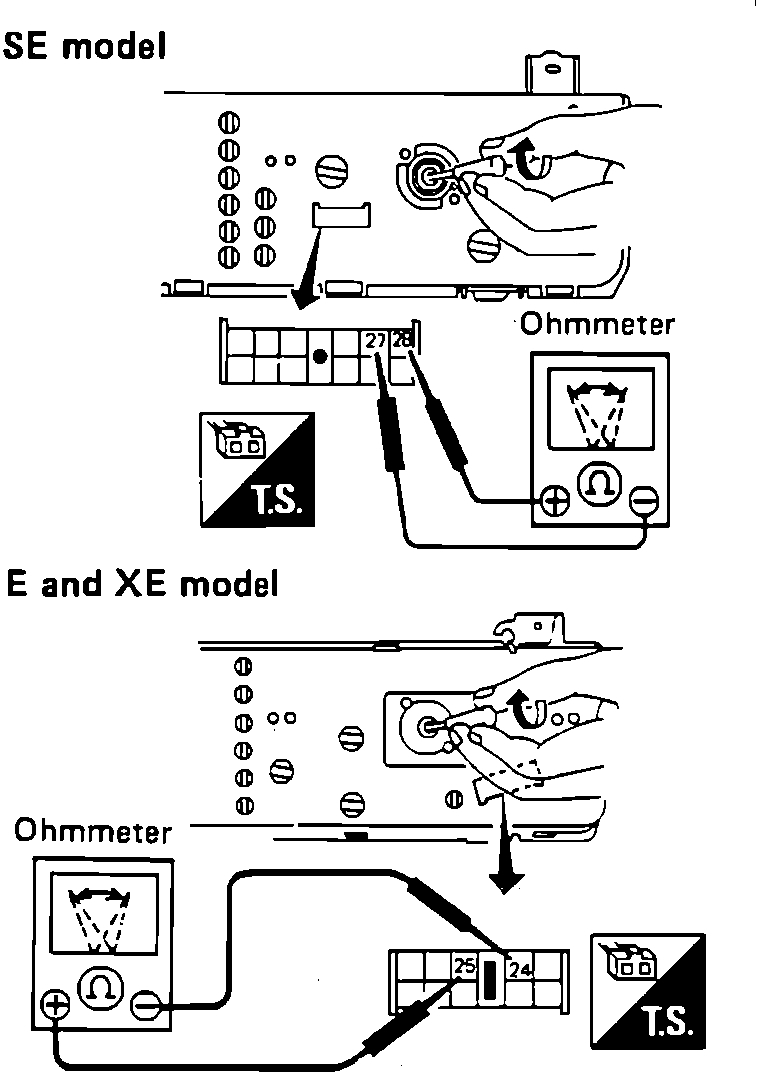

Here are the test directions for checking the sensor. Picture 2 shows what you are actually checking based on the model (SE, E, XE)
Let me know if this helps.
