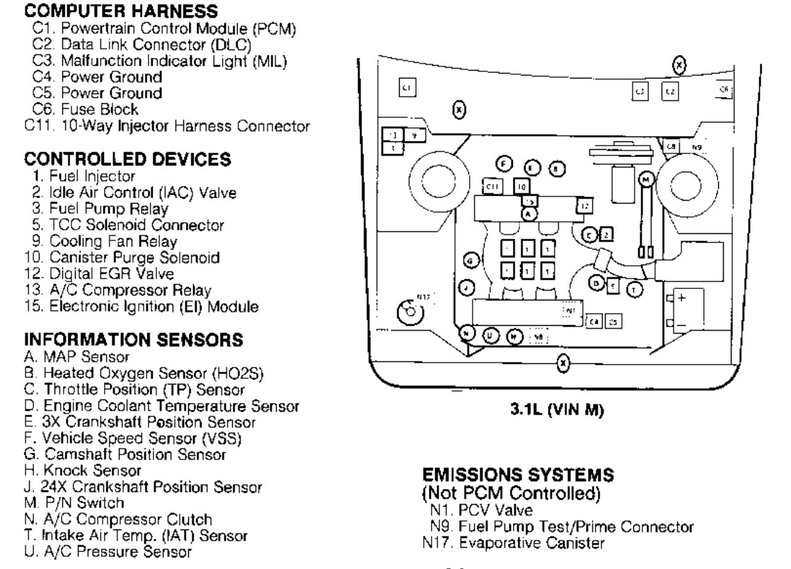

Speedometer does not work. is it the speed sensor and where is it located?

scan for codes first to see if it is speed sensor. item x in picture is air bag sensor.
