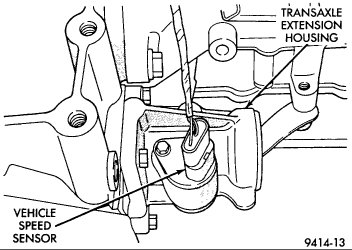

My first guess would be the speed sensor. It is not an expensive part, so I would start there. Also, make sure the wiring to it is clean, not corroded, and in good condition with no damage to the wiring or connector.
