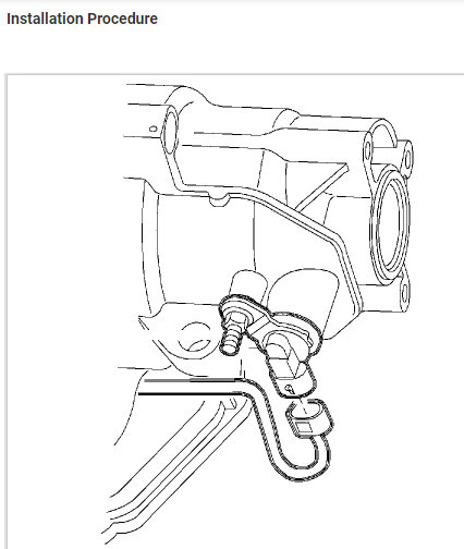

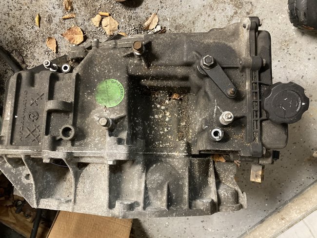

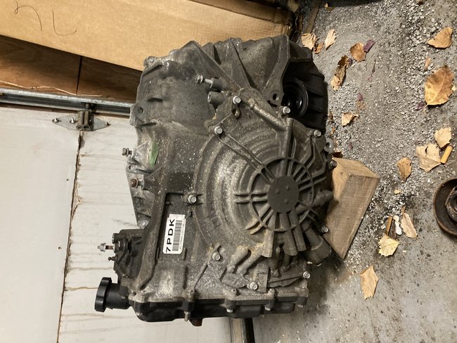

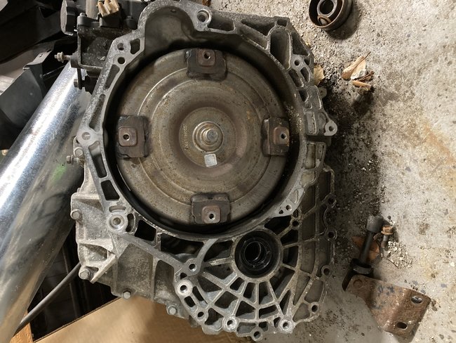

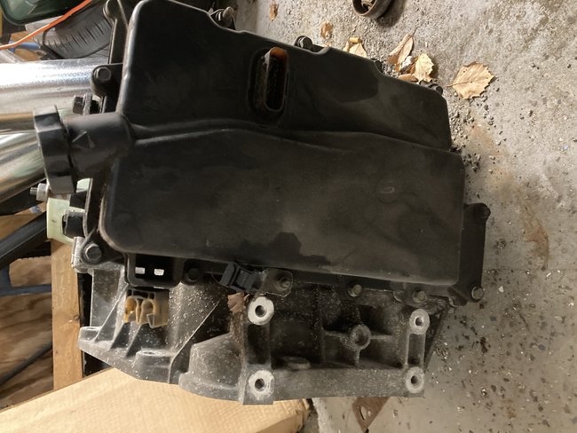

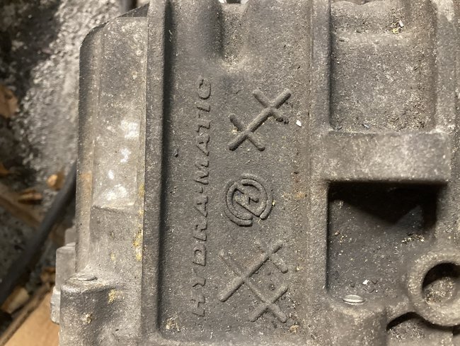

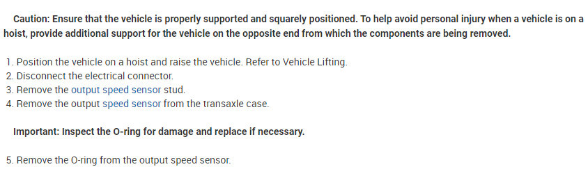

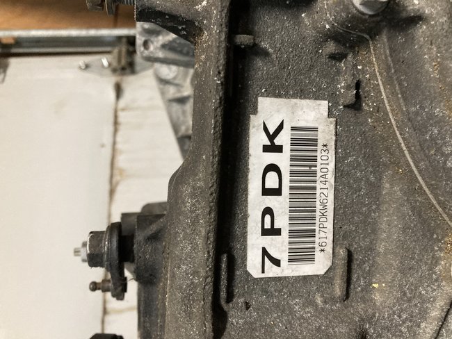

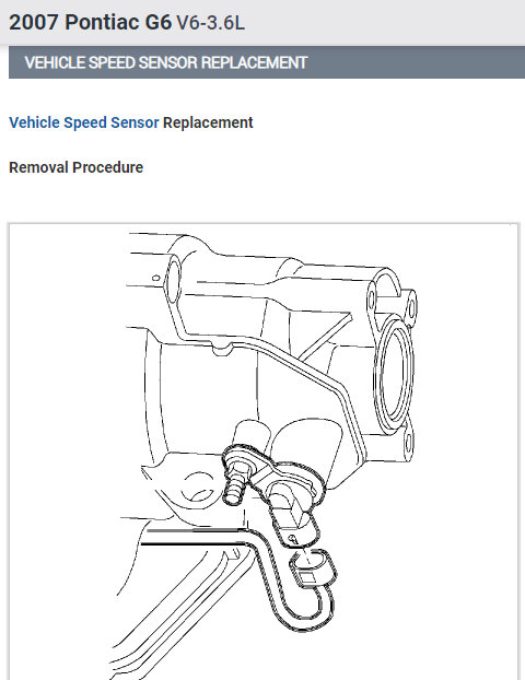

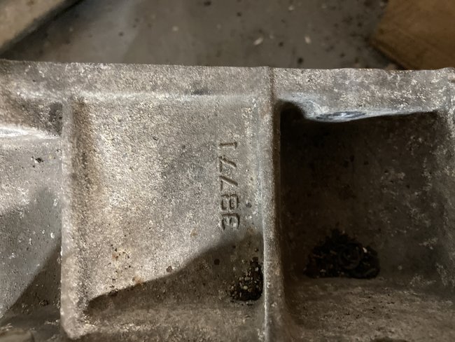

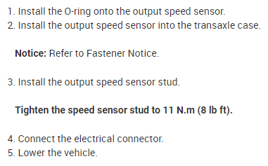

I have the car listed above GTP. I replaced the transmission with one from a Monte Carlo. My speedometer won't read over 25 MPH. It shifts fine. Took to a transmission place and said everything is reading normal for shifting. Said it could be a bad cluster so I replaced it and same issue. The transmission guy said speed showed 42 MPH when speedometer read 17 MPH. The speedometer was reading normal before the swap. There are no DTR codes. cruise control won't work until speedometer reaches 25 MPH and then works fine. I am doing approx 60 -65 MPH at that time. The OBD scanner cannot communicate with the cluster so not sure if that's the issue.
