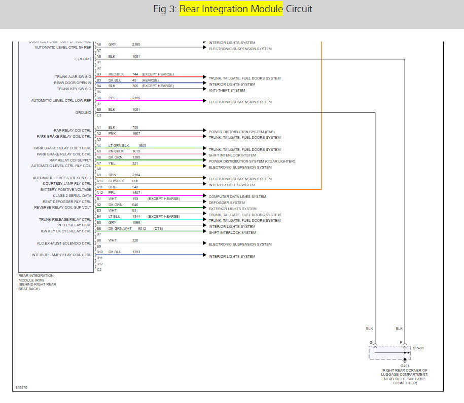

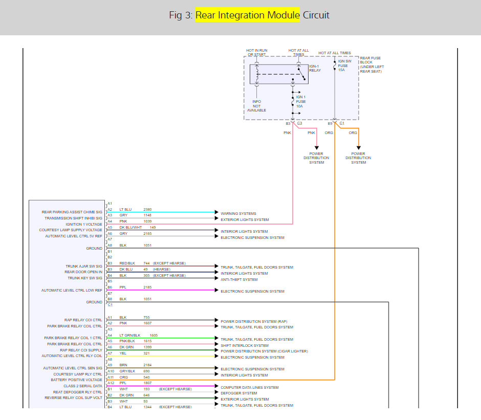

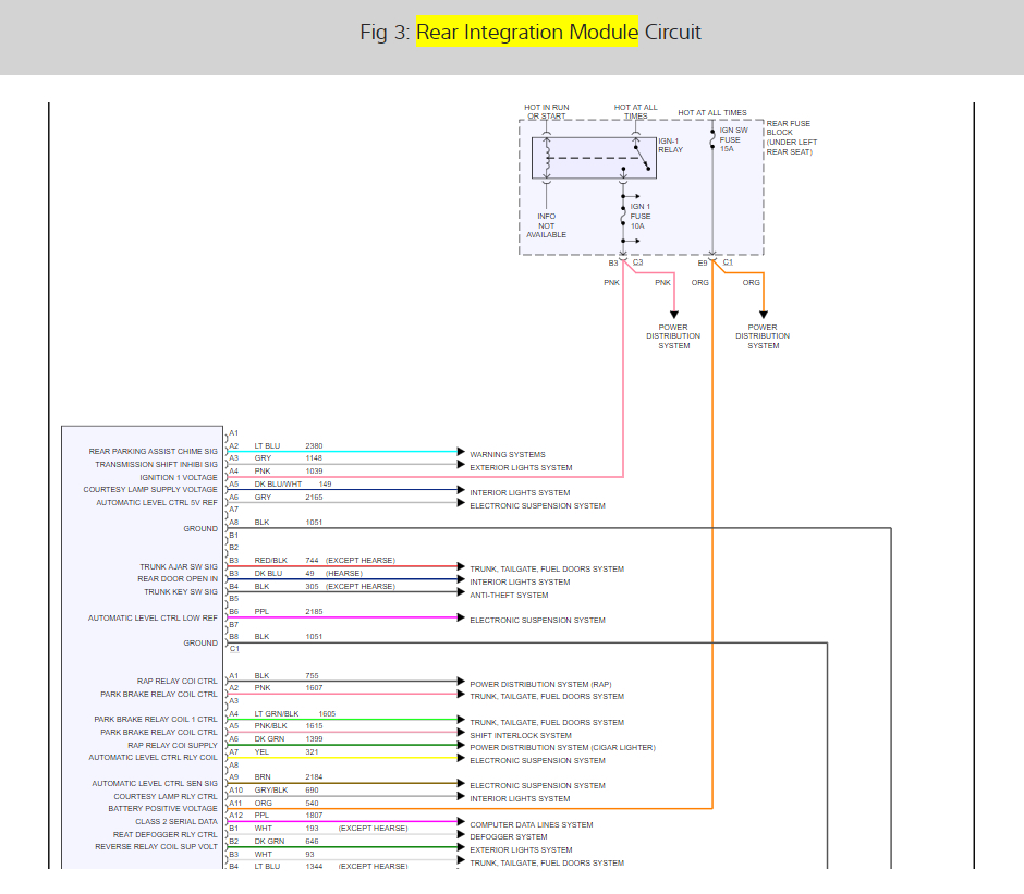

Replaced the rear integration module due to door locks, gas cap etc., not working. All that is now working but suddenly the speedometer and odometer are not working. Could this be related to the rear module work?
