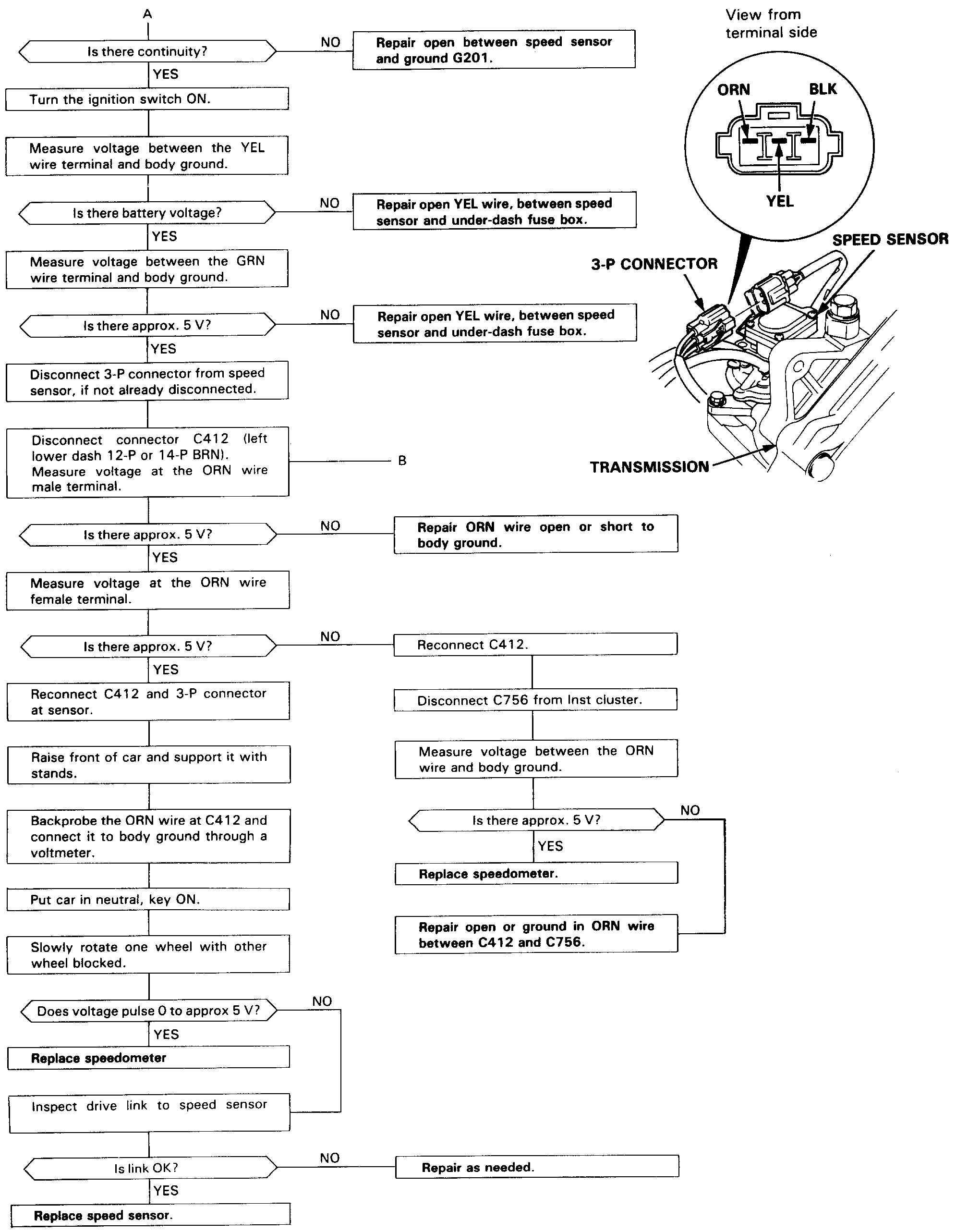

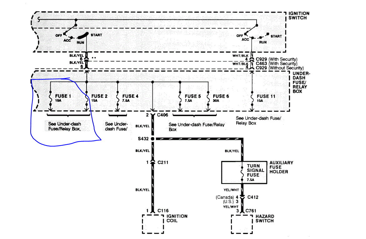

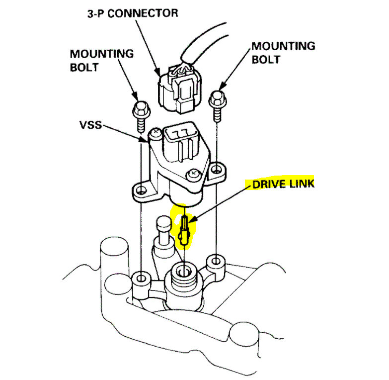

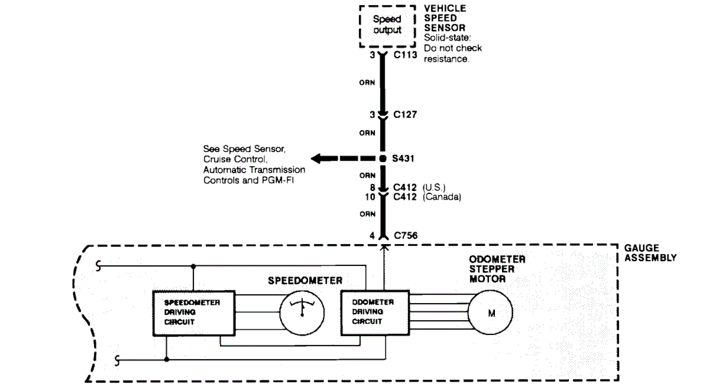

Speedometer occasionally worked prior to transmission replacement. after, almost everything except the speedometer worked but then tested cluster and it was bad. Replaced cluster with working one and speed sensor, speedometer and D4 light are the only things not working when driving. occasionally the battery light flickers on and off, don't know if this is helpful. Any help appreciated!
