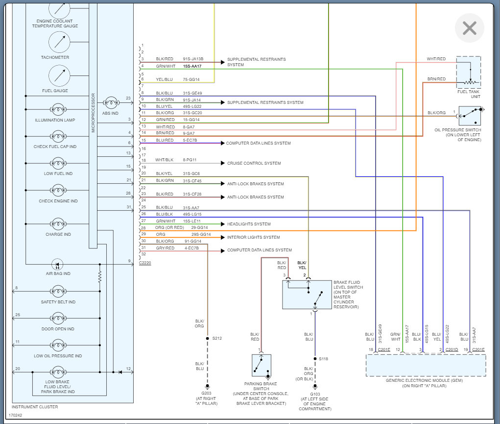

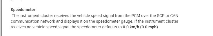

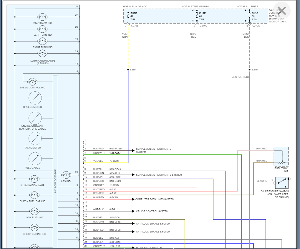

More than likely this is an issue with the cluster or the PCM. Basically, if the PCM is not getting a signal to the cluster via the communication network then the PCM is the issue.
We can start by checking the vehicle for codes and find out if we have any bus issues. Here are a couple of guides that will help with this:
https://www.2carpros.com/articles/can-scan-controller-area-network-easy
I am attaching the info below on the way this works which will give more details. However, if there are no codes then the likely issue is the cluster.
Please run through this info and let us know what you find. Thanks
