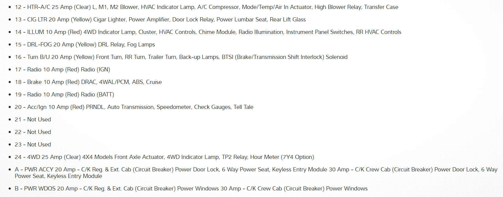

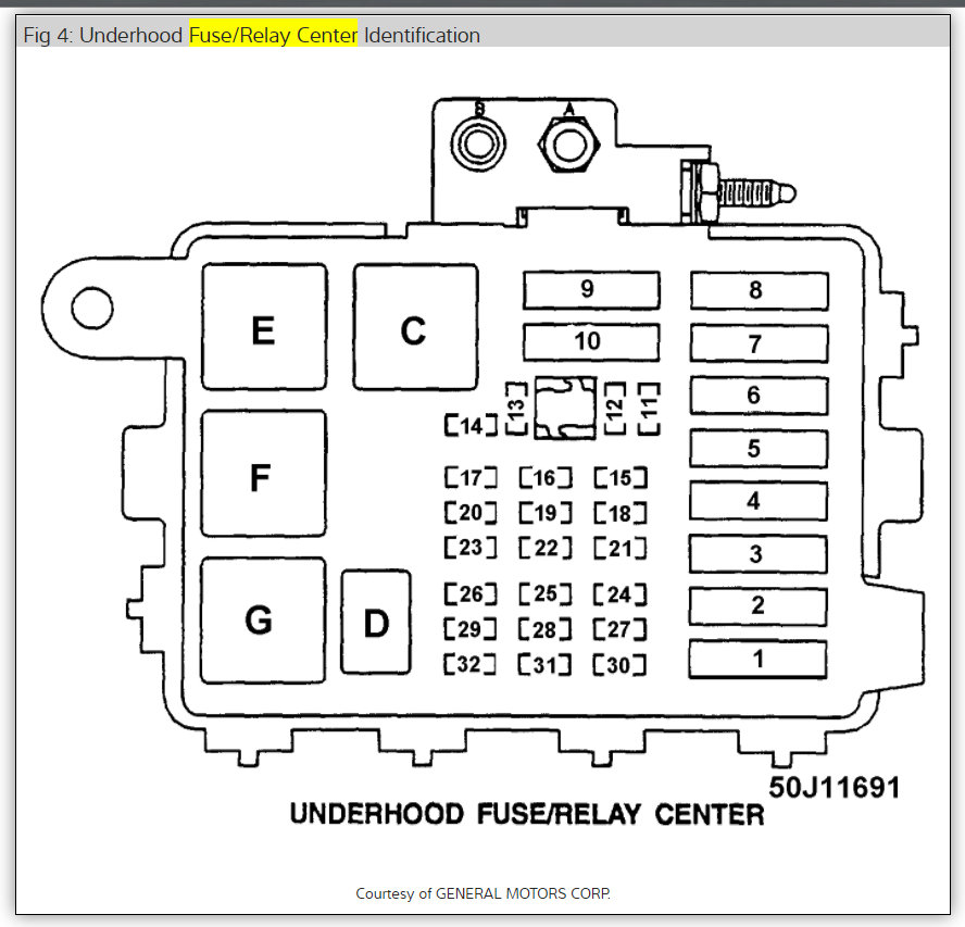

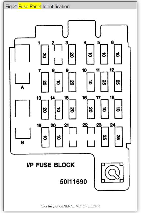

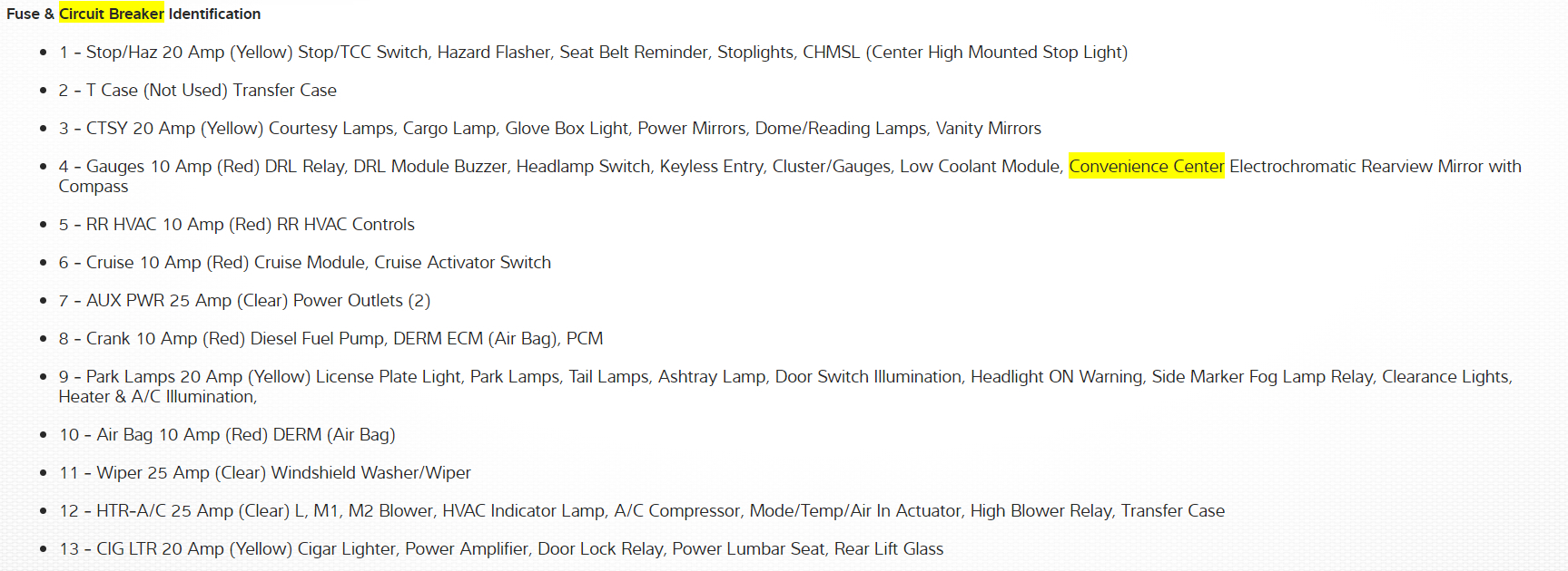

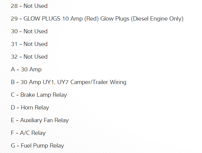

No speedometer, tachometer, or odometer but all other gauges working. Will not take off in first but can shift to first manually. Changed speed sensor on transfer case no change. Cluster looks fine when removed. Cannot find issue.
