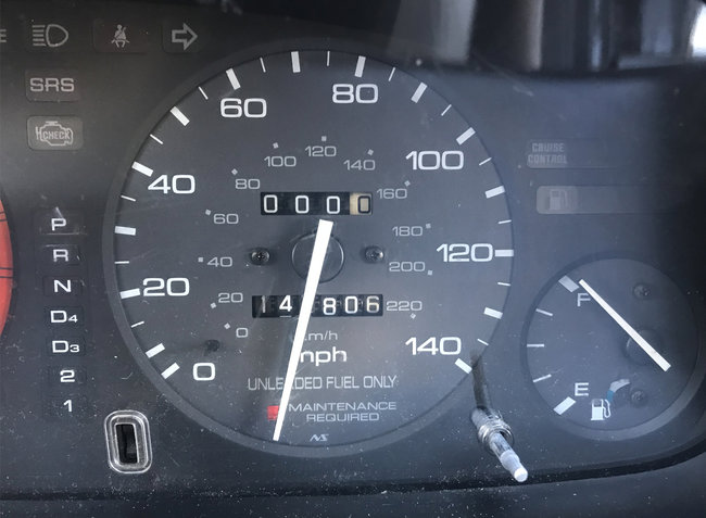

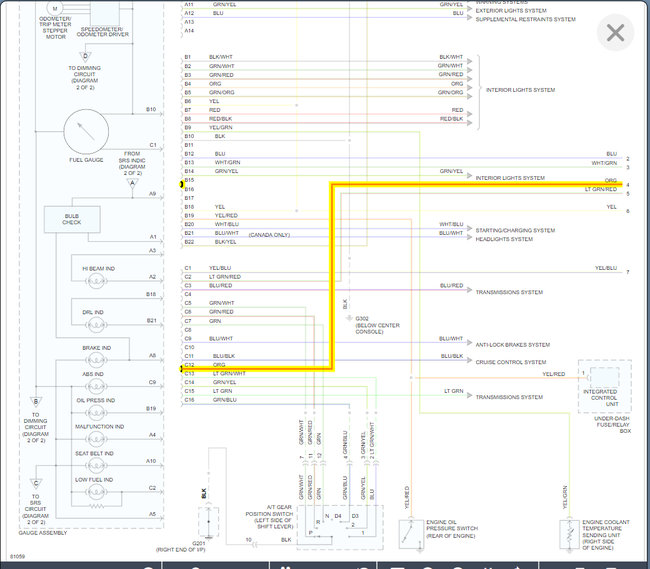

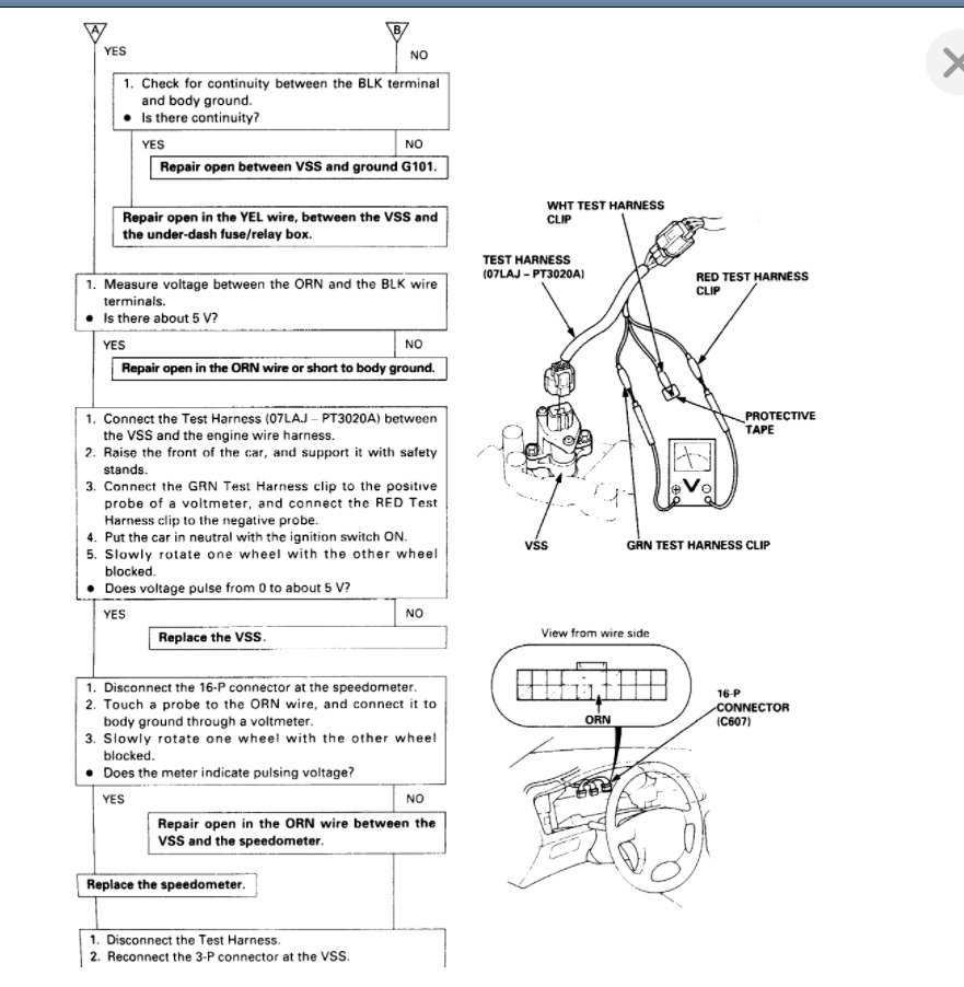

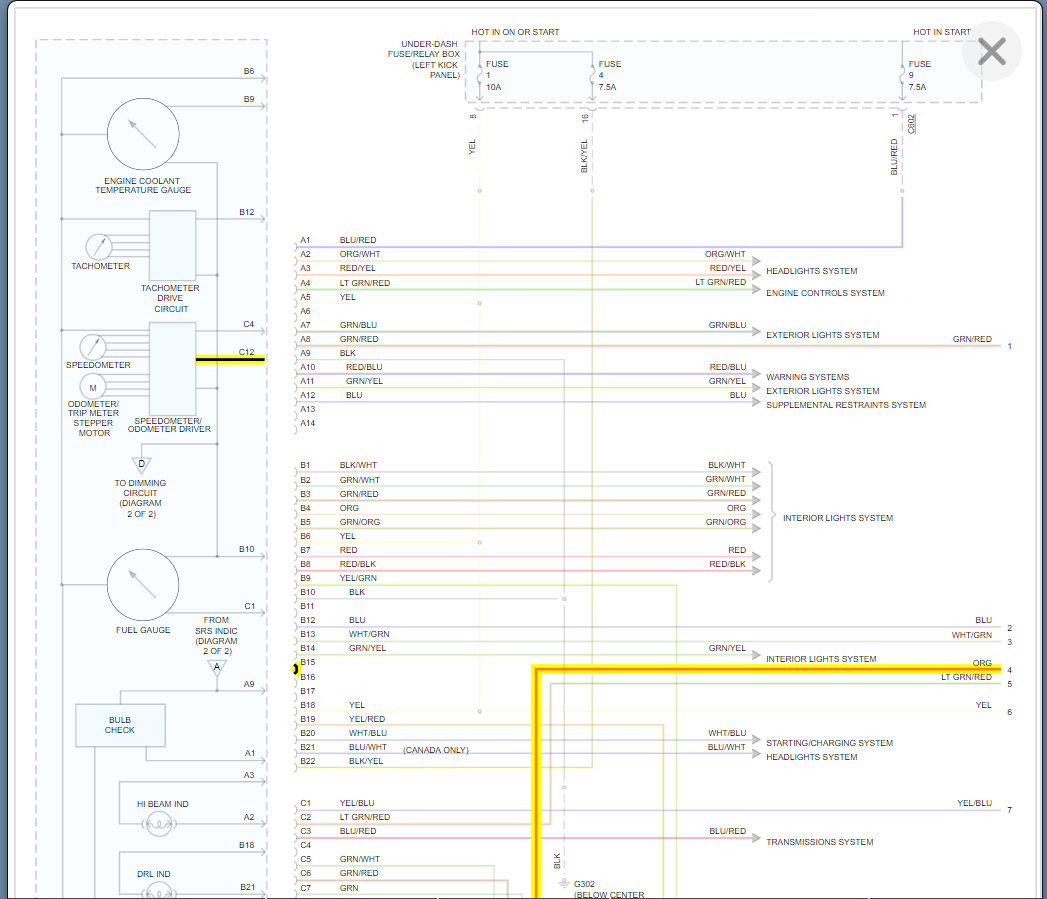

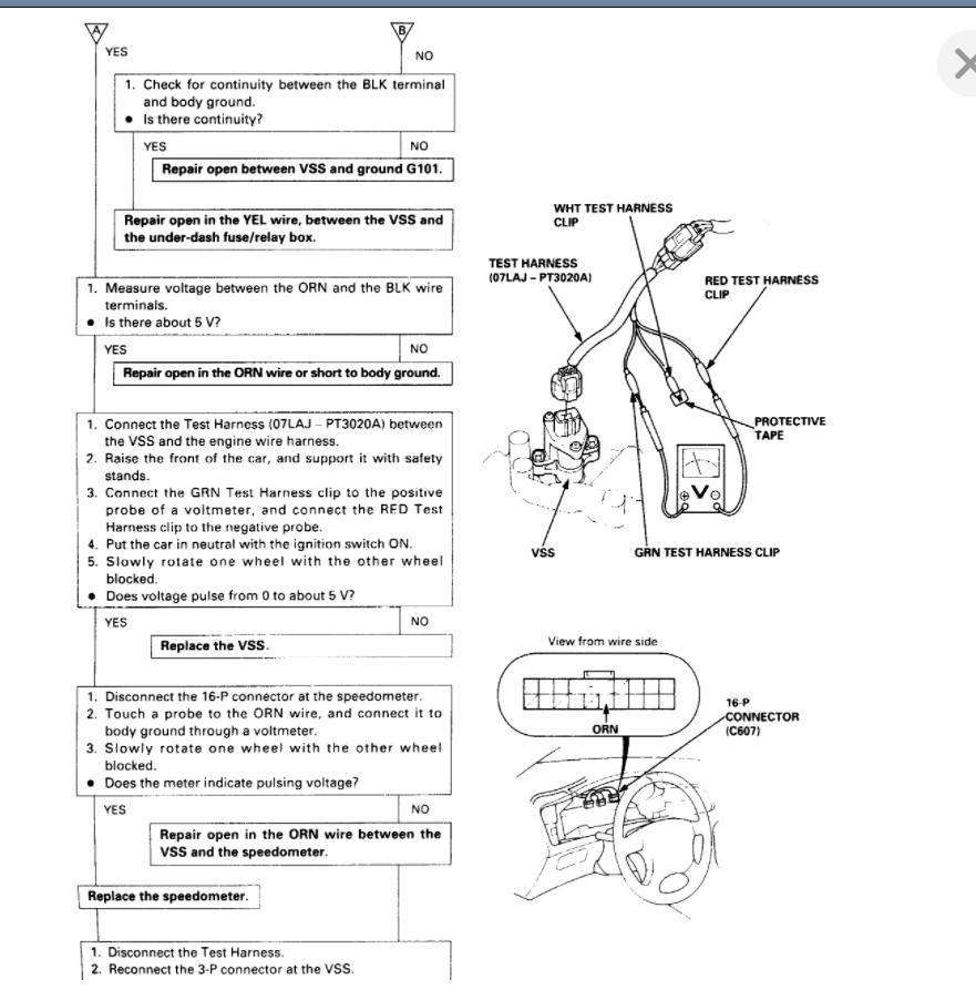

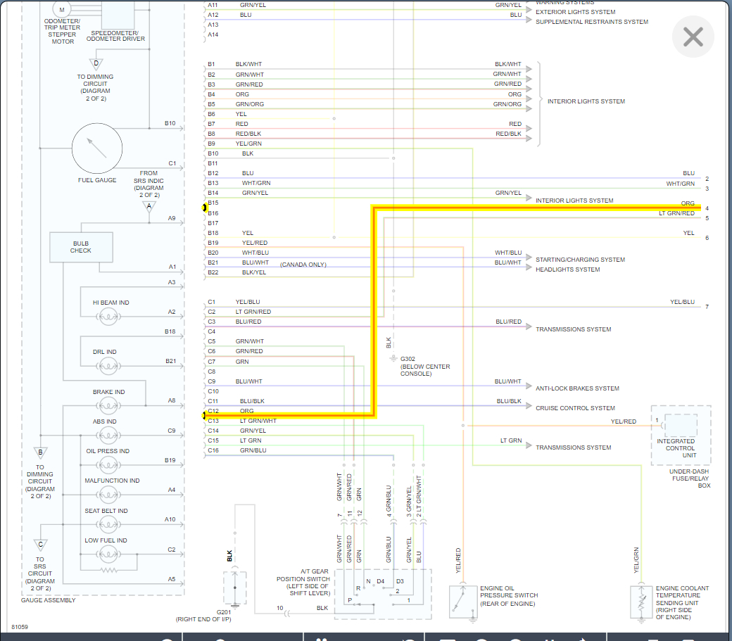

Speedo issue. The speedometer stays in the 6:00 position (below the peg at 0). When driving it will bounce to the Peg and stop there.
Odometer, Tripmeter and cruise control all work when driving.

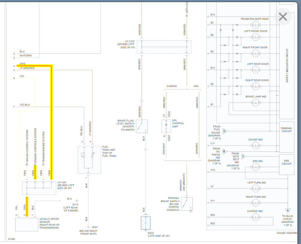

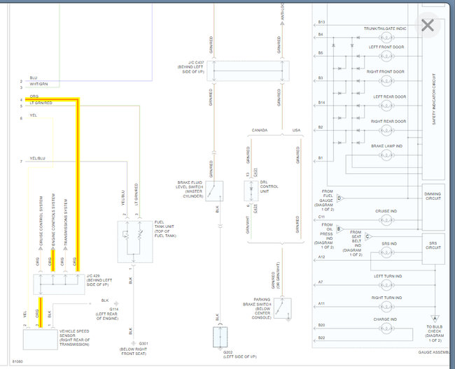

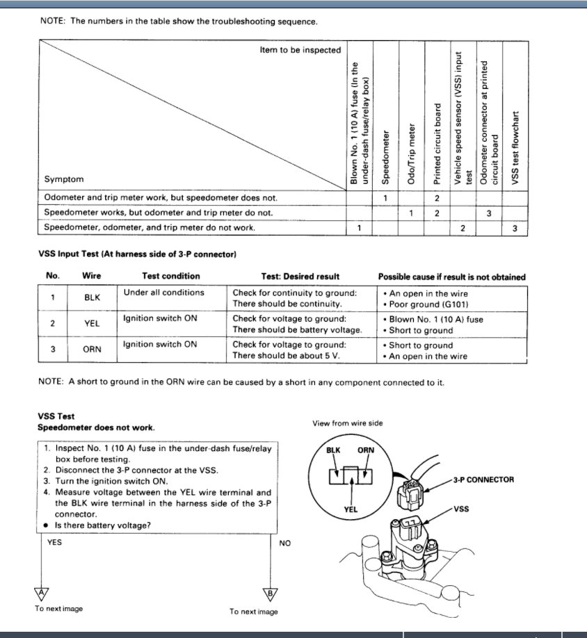

Replaced VSS since it's pretty simple even though now CEL showing. Checked the voltage and continuity on the VSS clip. All good with readings of ~5v and ~12v and good ground.

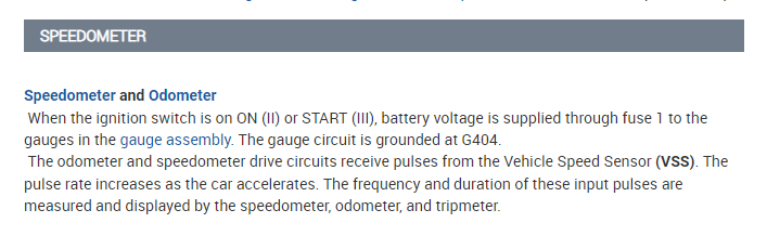

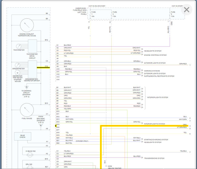

Before I buy a new dash cluster and try that, anything else I can check to confirm it the cluster?
