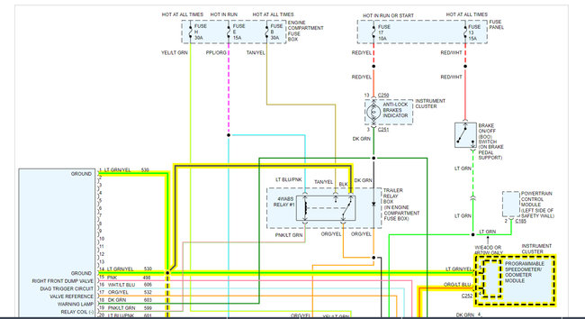

always had a hard shift into second gear. now odometer and speedometer don't work. replace speed sensor on rear and speed gauge.
Mar 10, 2021 at 6:02 PM
Good morning,

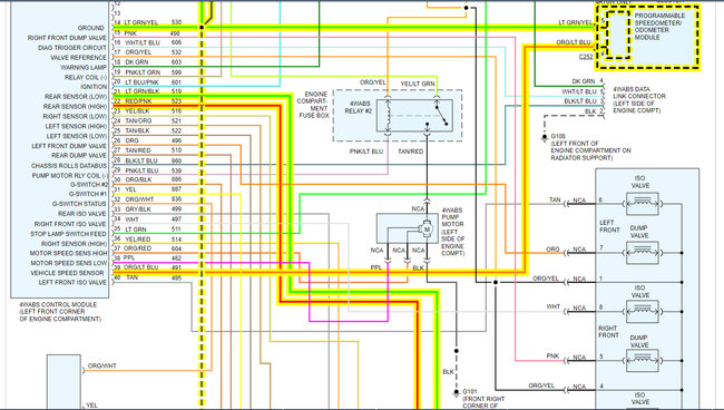

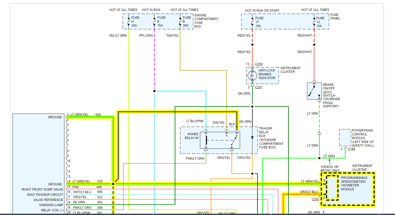

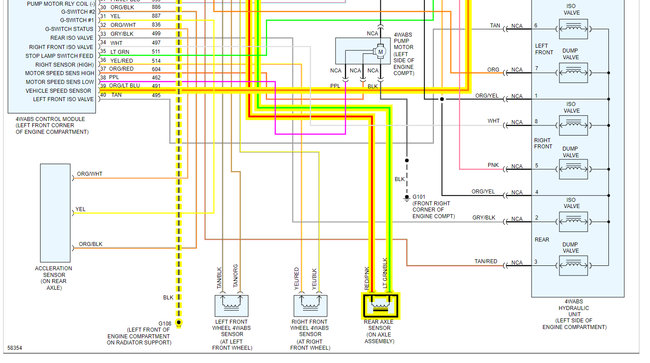

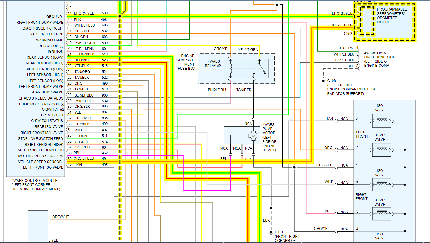

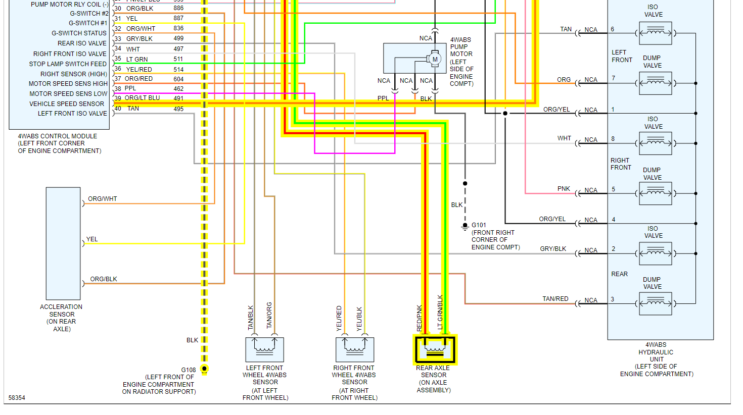

The rear ABS sensor is the speedometer control as well. It sends a signal to the ABS module which sends a signal to the dash for speedometer. It also sends a signal to the transmission.
https://www.2carpros.com/articles/how-to-replace-a-abs-controller
This is most likely the reason the shifting is hard. Without a speedometer signal, it will not shift smoothly.
The four wheel Antilock brake system control module is located in the LH front corner of the engine compartment behind the driver's side head lamp on a bracket mounted on the surface of the plastic fender apron.
