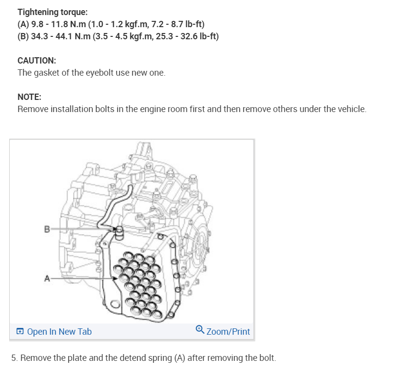

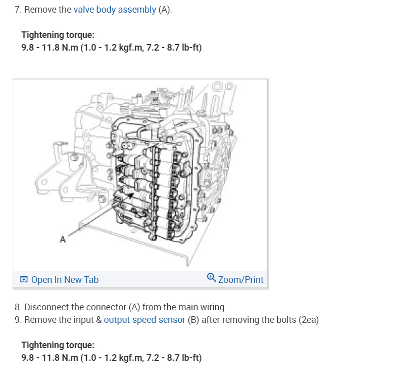

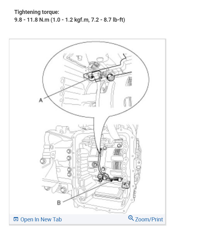

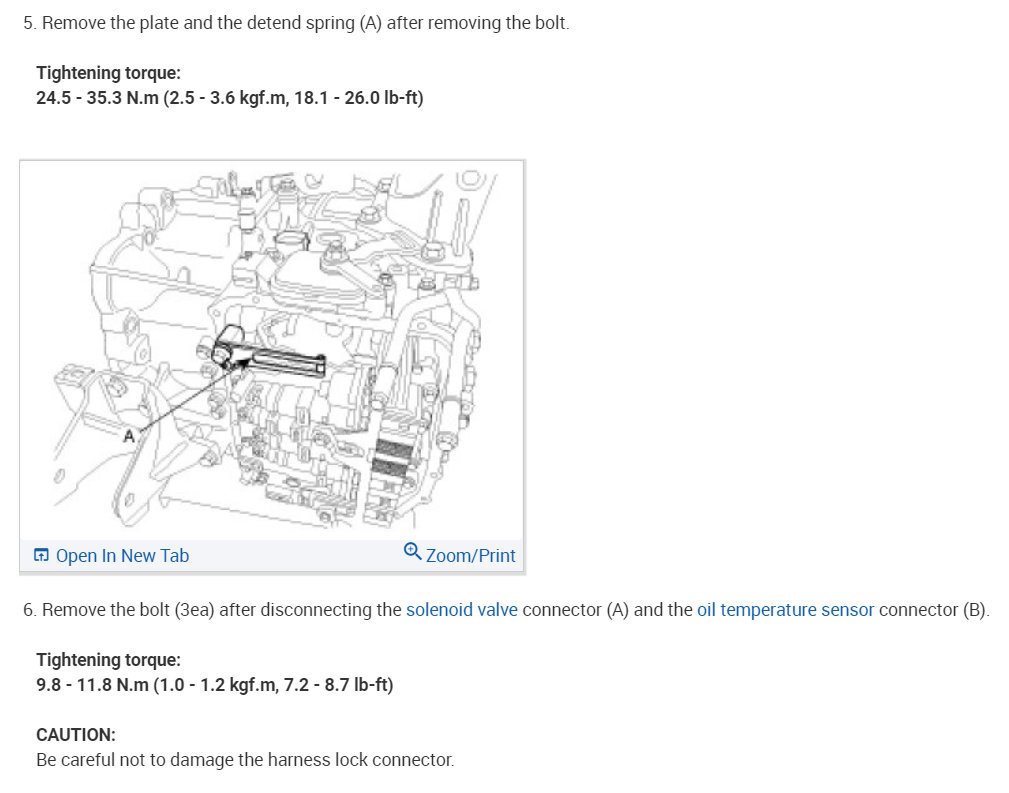

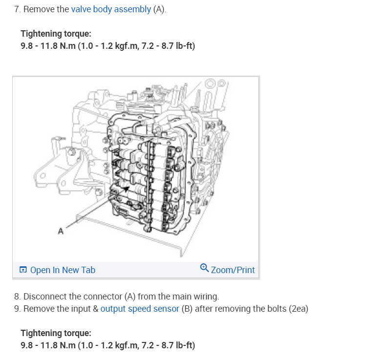

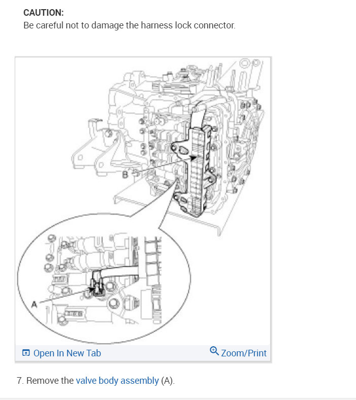

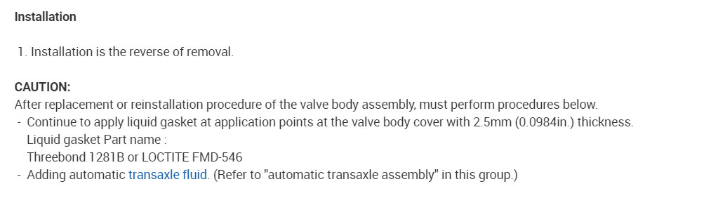

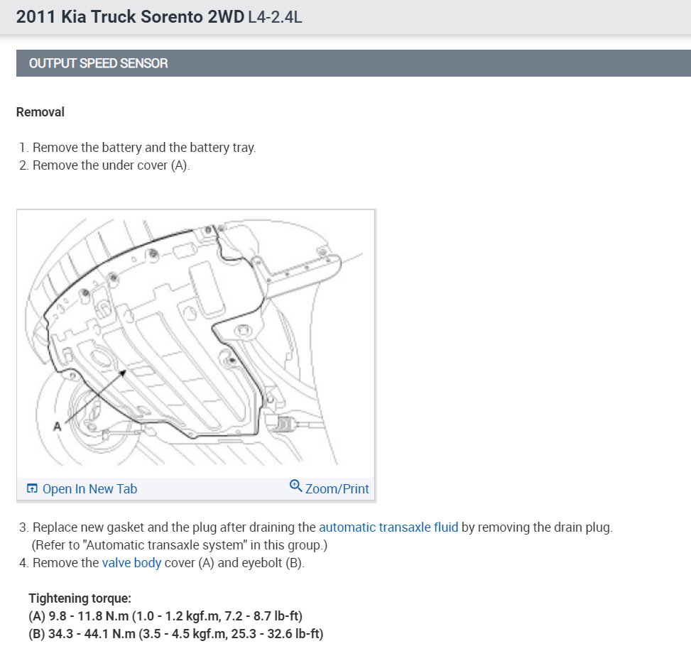

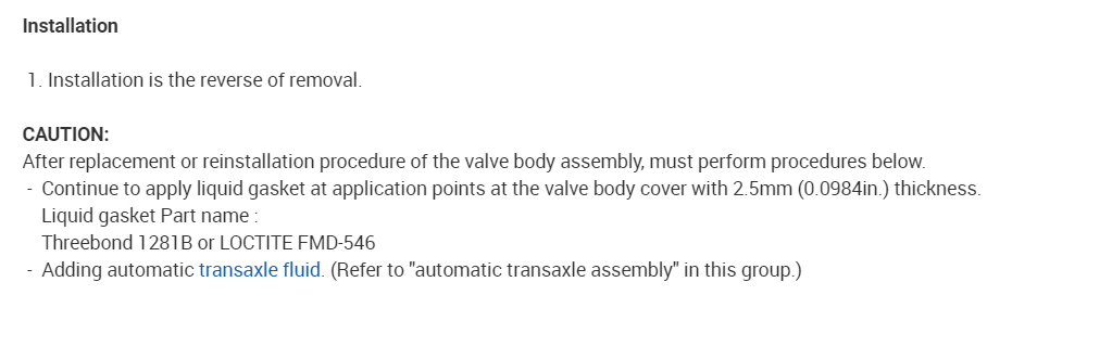

The problem is with your VSS or transmission output sensor. Here is how you can change the sensor out which is inside the transmission near the valve body, Check out the diagrams (below). Please let us know if you need anything else to get the problem fixed.
