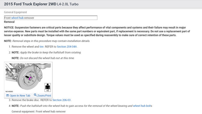

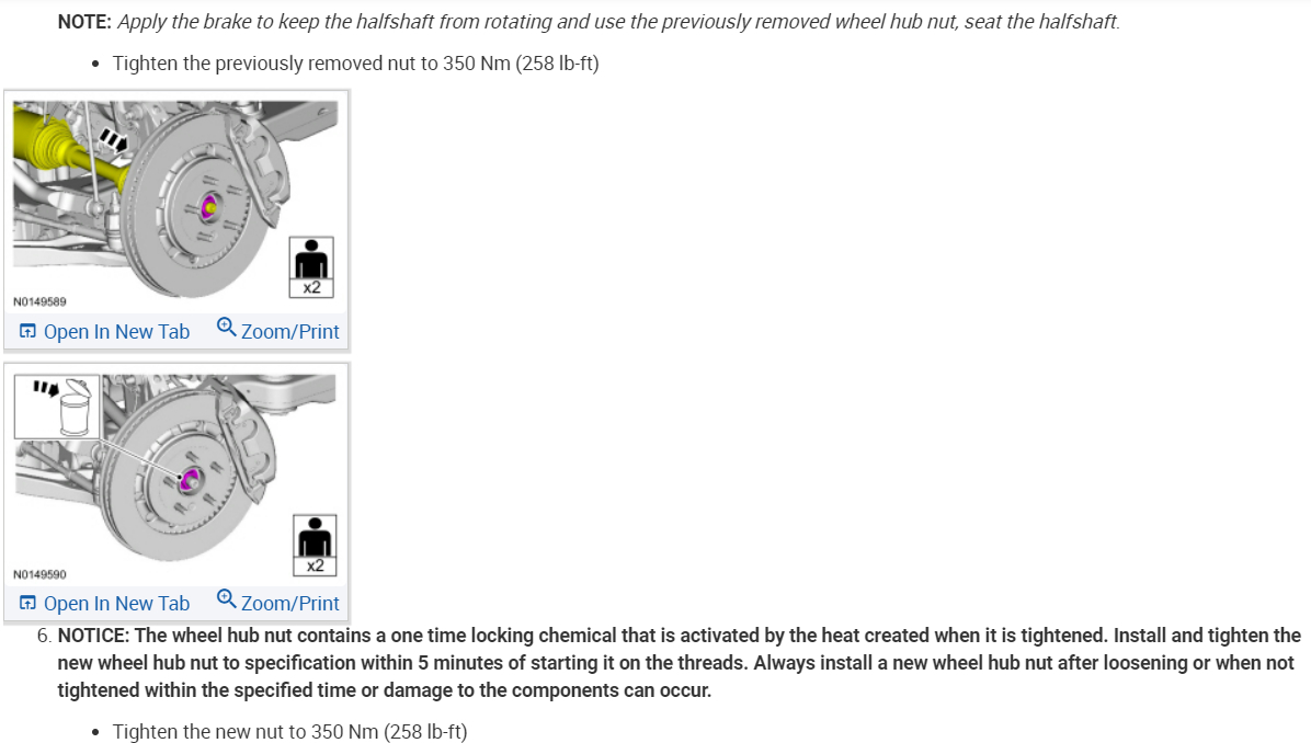

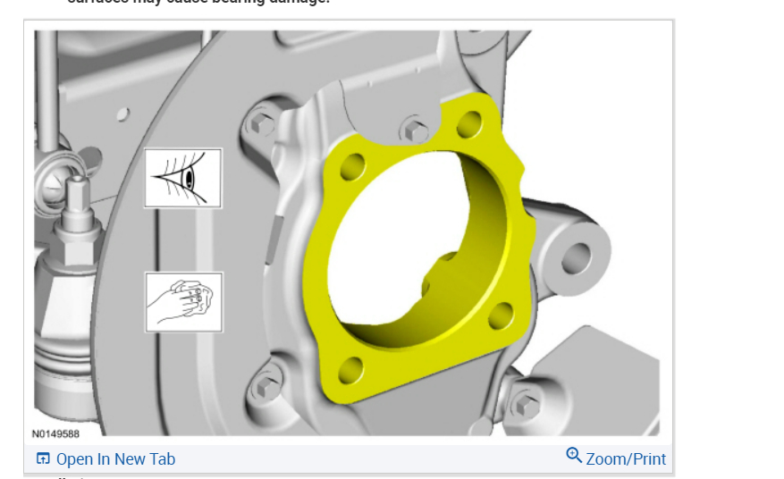

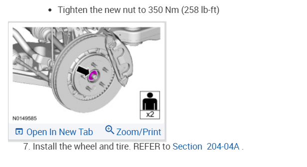

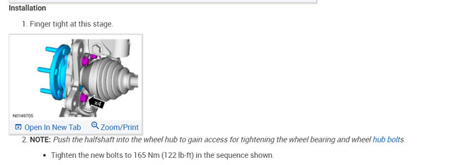

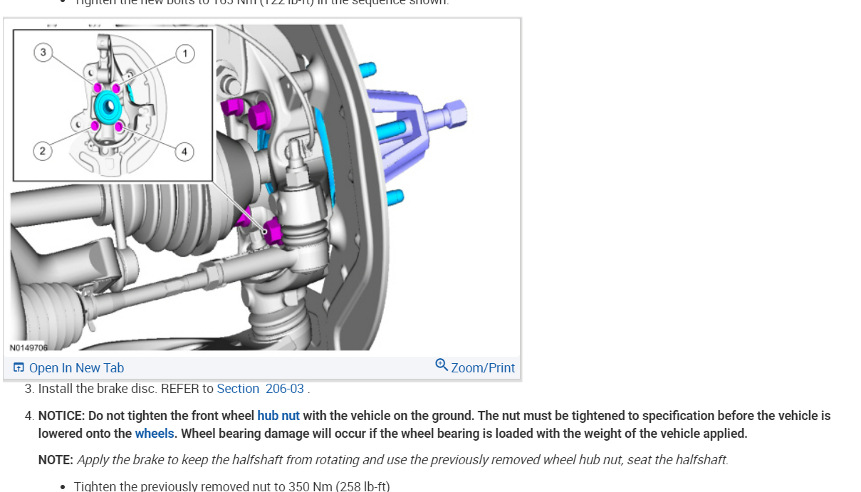

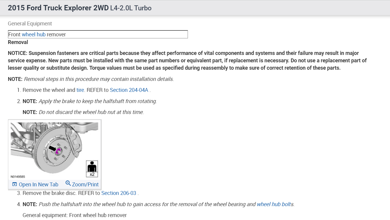

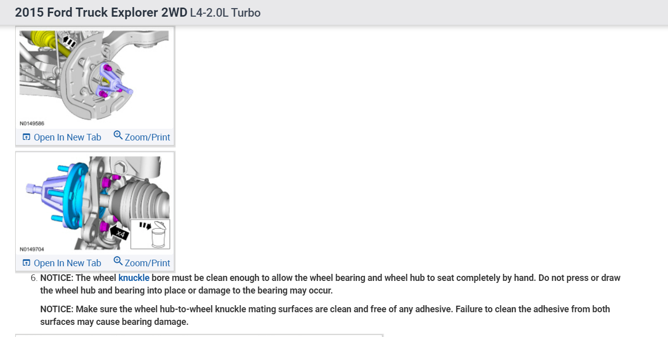

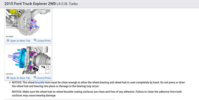

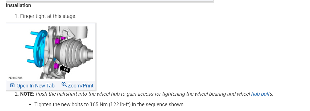

Bad PTU? not sure what that is, anyway, it sounds like you have a bad front bearing hub which affects the ABS and traction control system. This problem would be intermittent, which is why Ford can't find it. Here is how I would fix it in the diagrams below. Replace both front hubs. Check out the diagrams (below). Let us know what happens and please upload pictures or videos of the problem.
