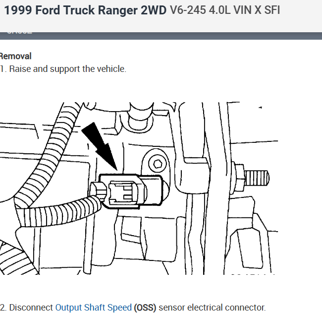

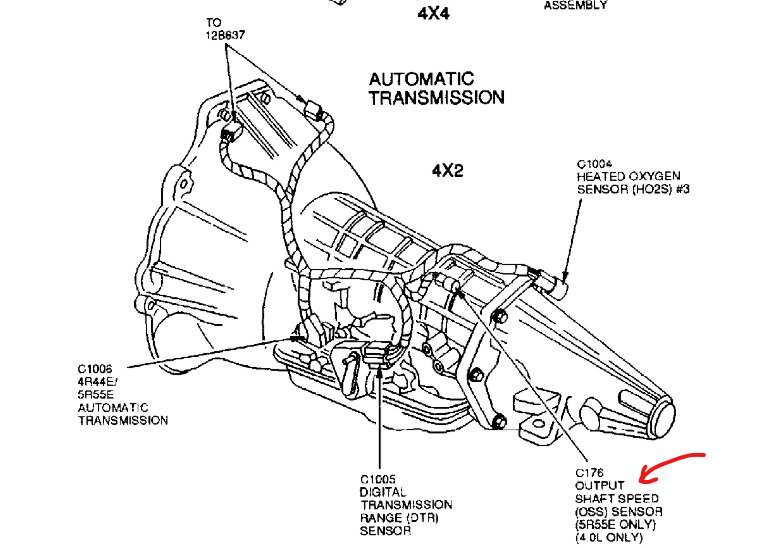

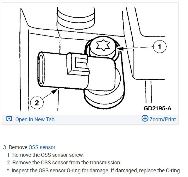

Can I ask if the speedometer is working, if not the VSS (output speed sensor) will need to be replaced here is the location of the part so you can swap it out.
It would help if you ran the codes to see which ones are stored to help confirm the issue.
Clear the codes once the repair is completed. Check out the images (below). Please let us know what happens.
