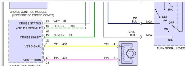

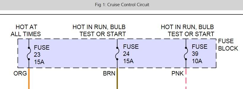

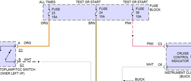

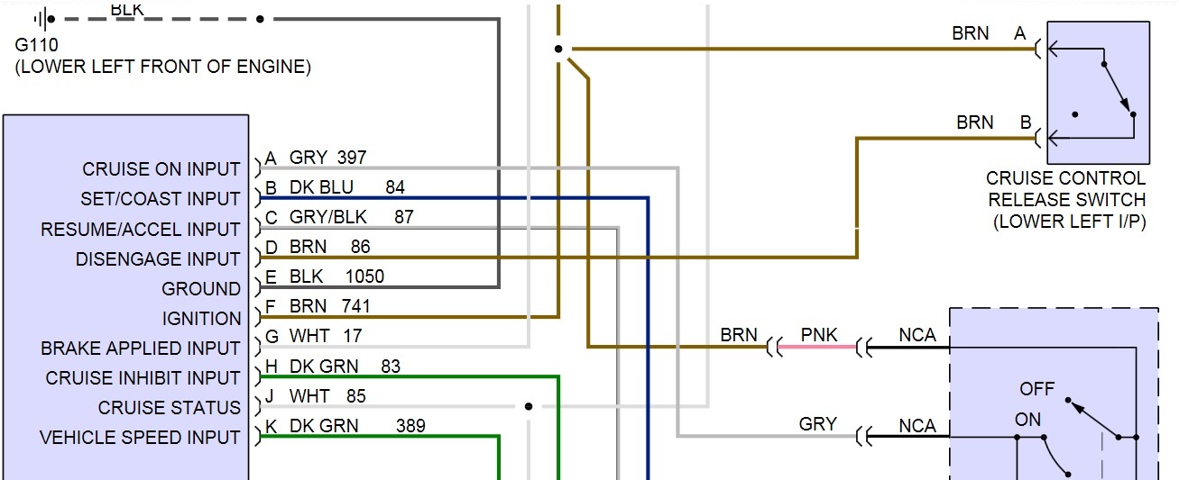

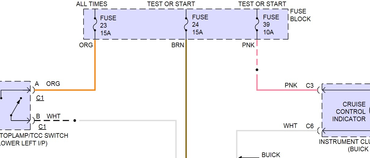

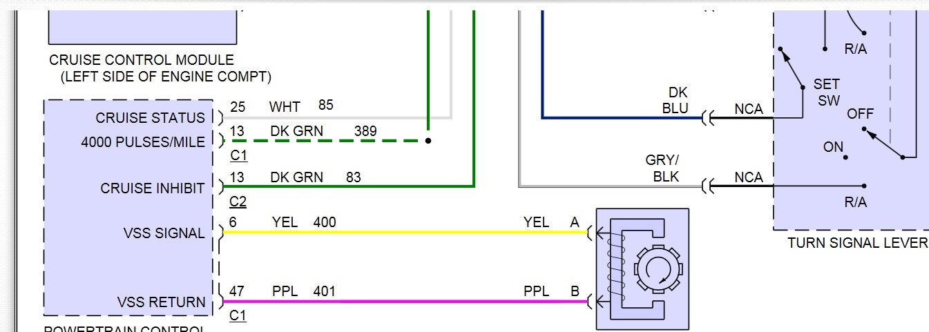

Were there any codes for the cruise control? Here is wiring diagram for cruise. Follow the wiring diagram for cruise, see if you can find a problem, voltage or ground.
