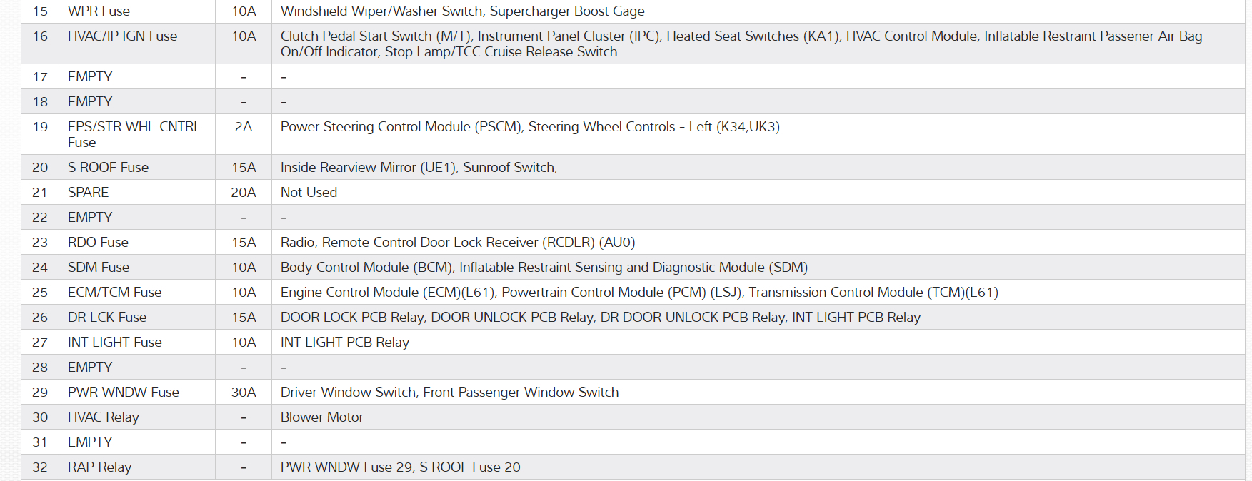

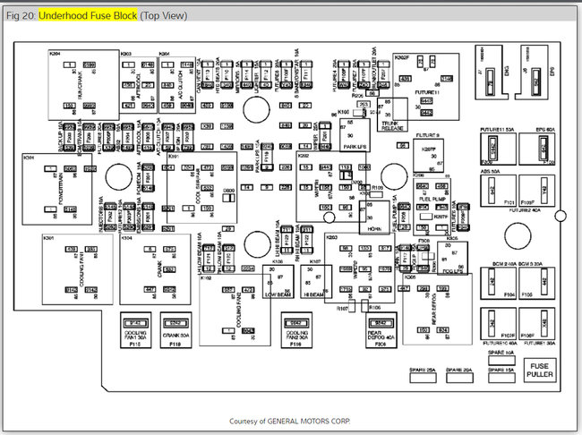

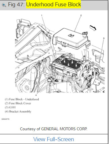

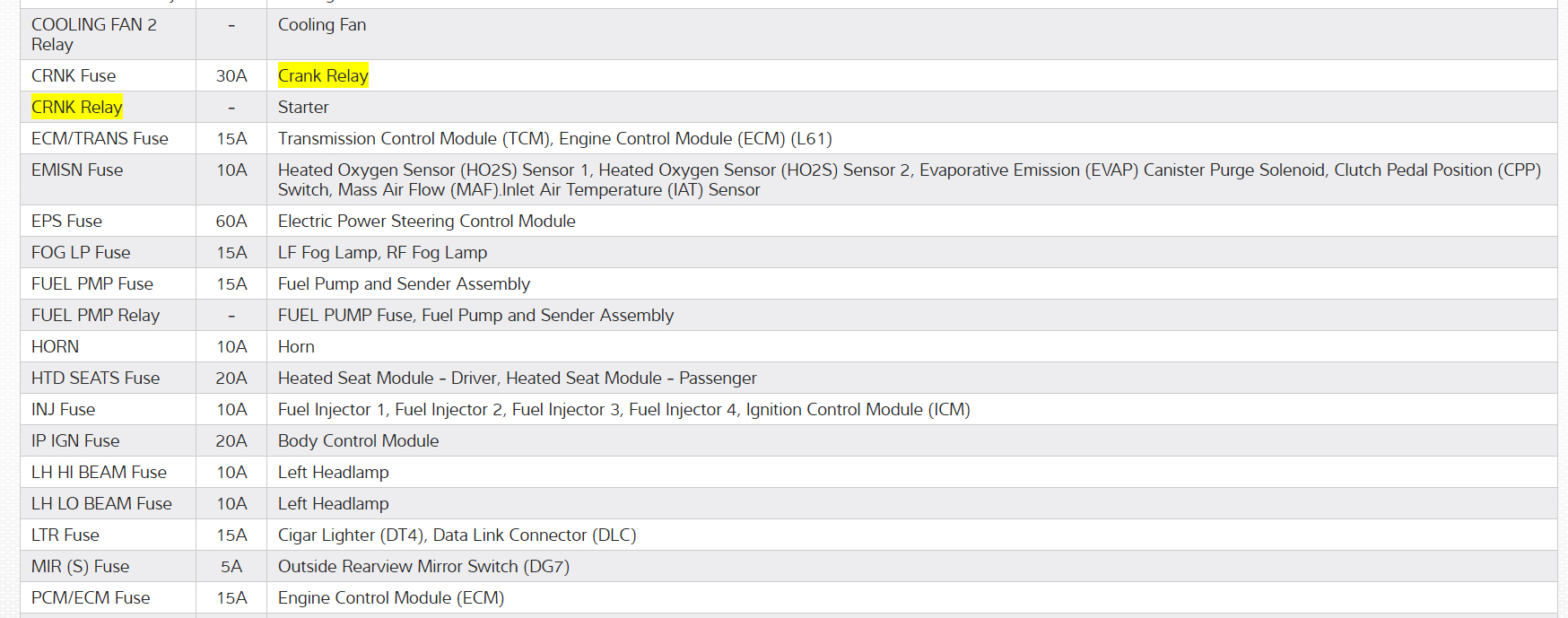

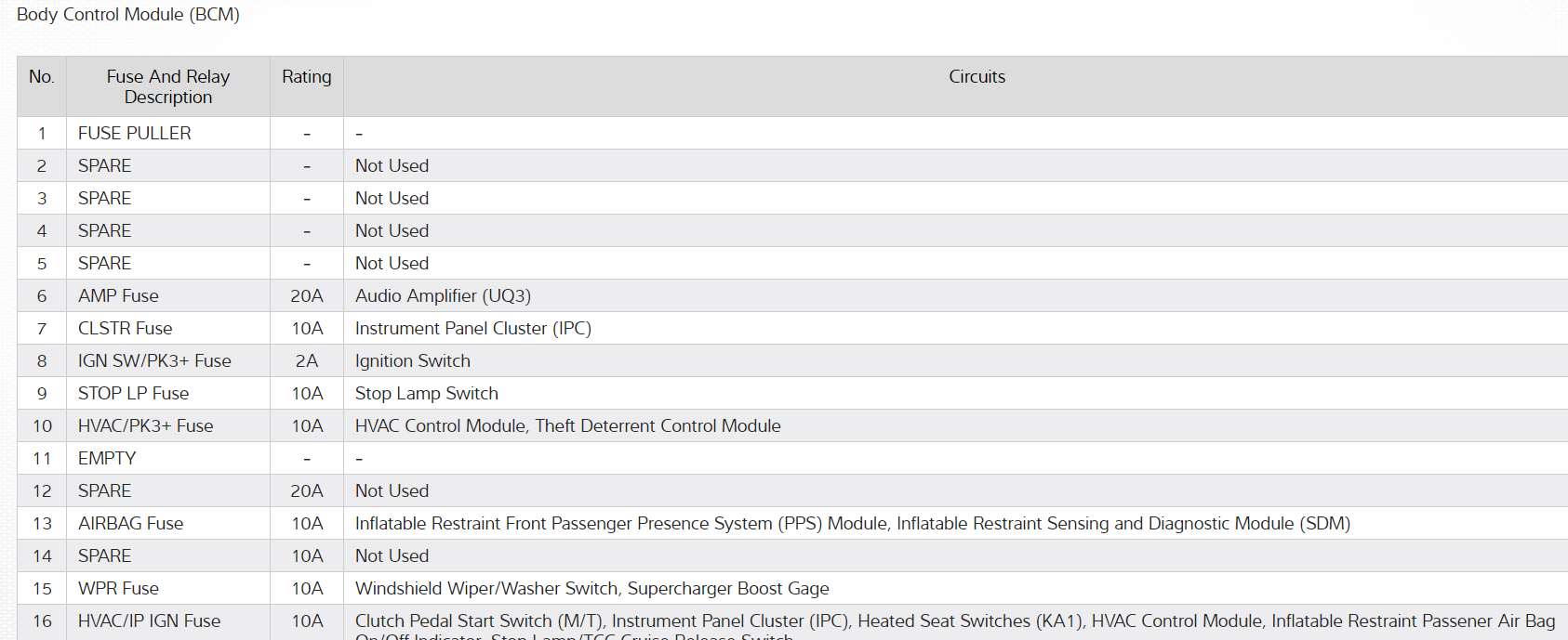

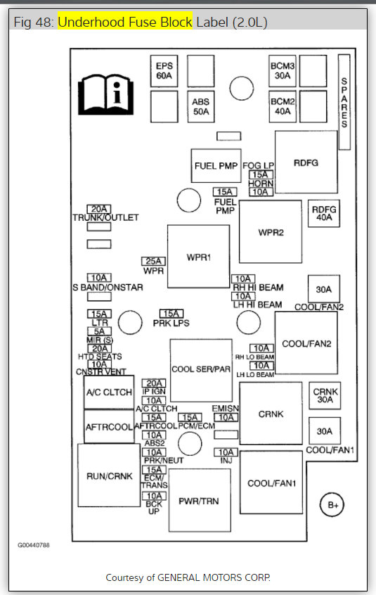

Hi everyone,

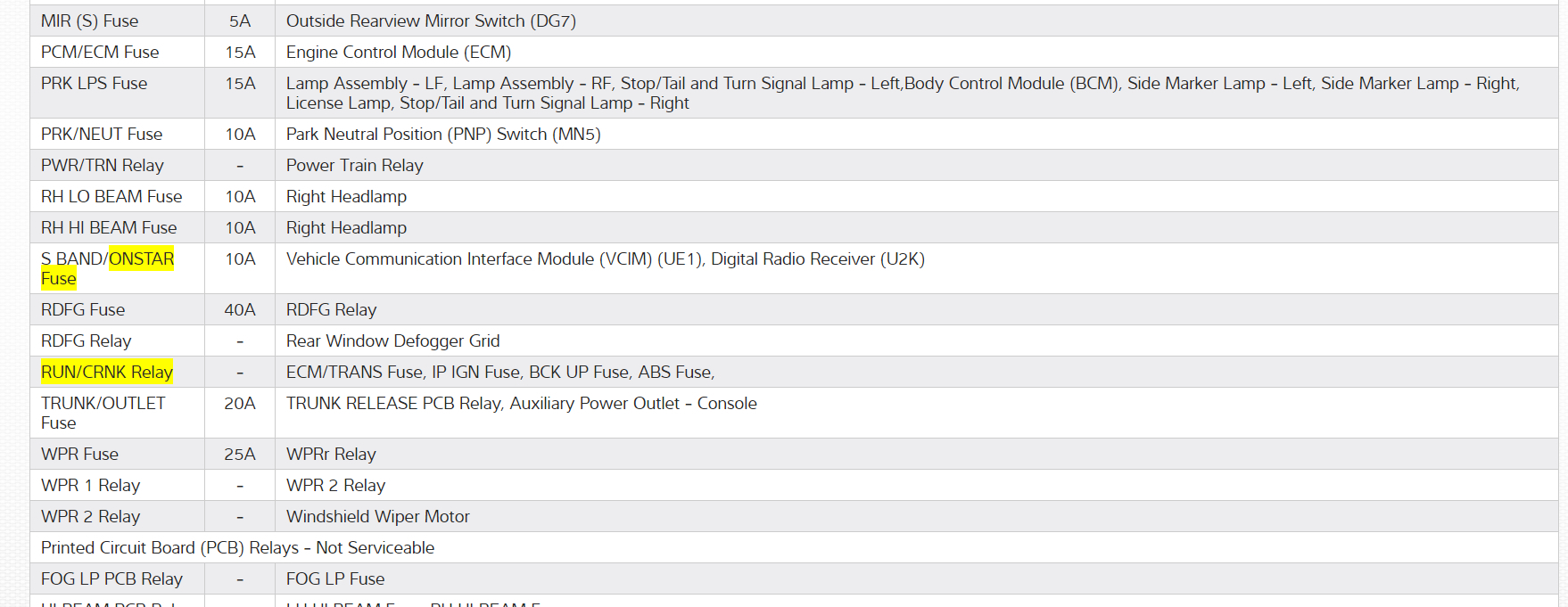

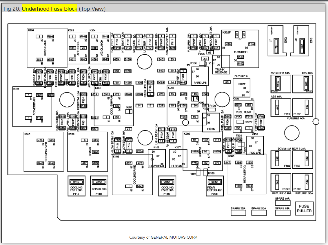

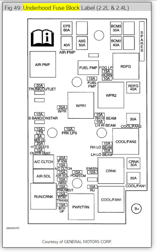

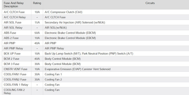

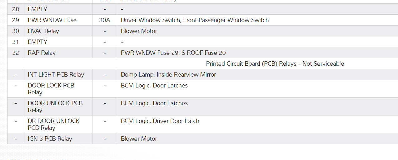

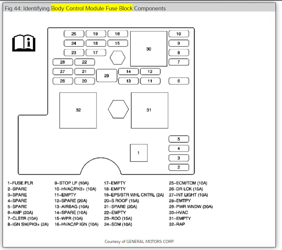

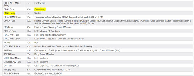

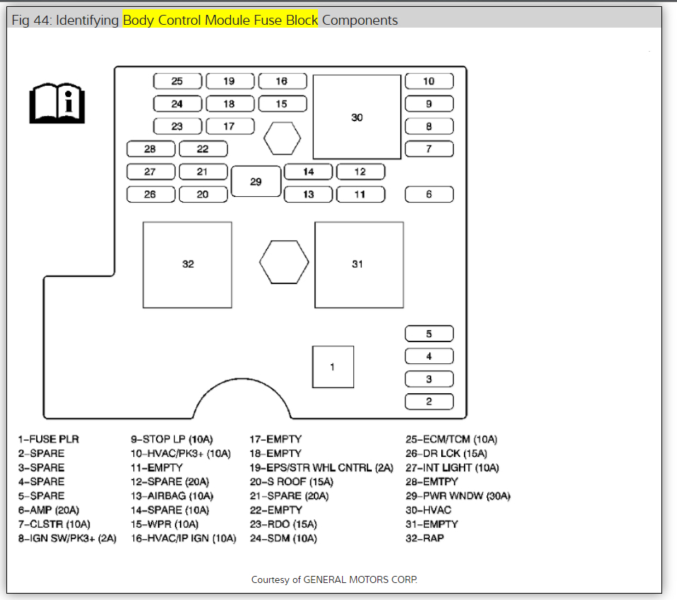

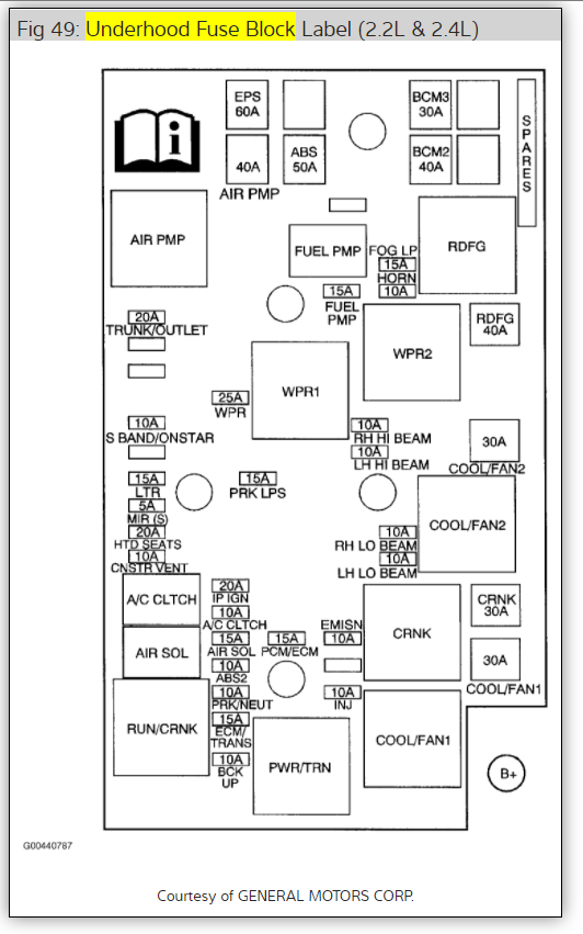

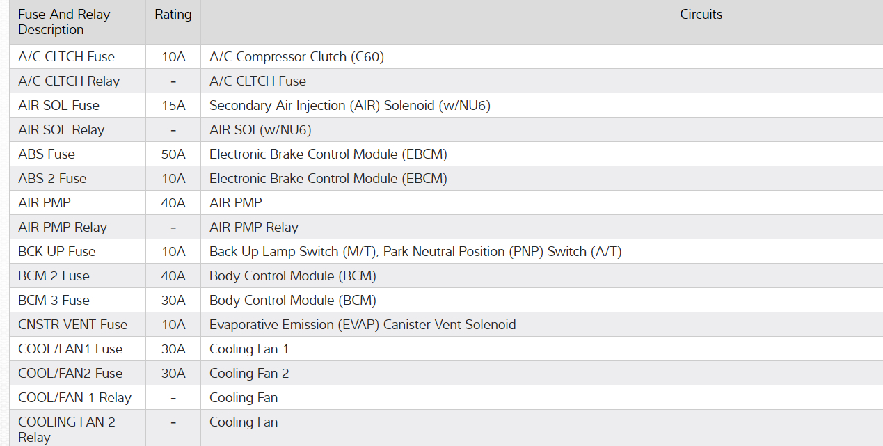

I went out this morning to start my Cobalt and the battery was gone. I called AAA who came out and replaced my battery. I thought I was good to go after this. Once I started my car, I noticed that the temperature indicator wasn't working and once I started to drive, I noticed that the speedometer isn't working and the car won't shift past first gear. AAA tried to jump start my car before they replaced the battery, and I'm thinking that a fuse might've been blown out whenever they tried to do so, which may be causing the problems with the car not shifting and the speedometer/temp indicators not working.
When I called AAA and told them about this, they sent someone out to my house who looked at the car and basically told me that I was full of it to think that a battery switch could be causing all of these problems...yet, the car was working fine before the battery was switched out and the car was jump started.
I don't have a method to check the voltage on the fuses right now. Anything in particular I should tell the mechanic to check/look out for?
Can anyone provide some insight as to what might be going on here?
Thanks,
Chad
Jul 16, 2020 at 7:22 PM (Merged)
It sounds like fuses got blown when the battery was changed, could be becasue the key was left on when the battery was connected. You will need to do a visual inspection on all fuses, here is a guide that will help you and the fuse location below.
Check out the diagrams (Below). Please let us know what you find. We are interested to see what it is.

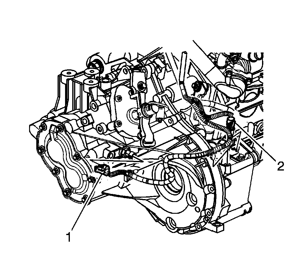

Welcome to 2CarPros.
The idea that the speedometer isn't working indicates an issue with the vehicle speed sensor (VSS). The sensor's signal is used to determine shift points. Have you replaced the VSS or checked wiring to it?
_____________________
There are two different possible automatic transmissions used on this vehicle. I am going to provide the directions for replacing the VSS for both. You should be able to identify the transmission that matches yours by the pictures. All attached pictures correlate with the directions.
______________________

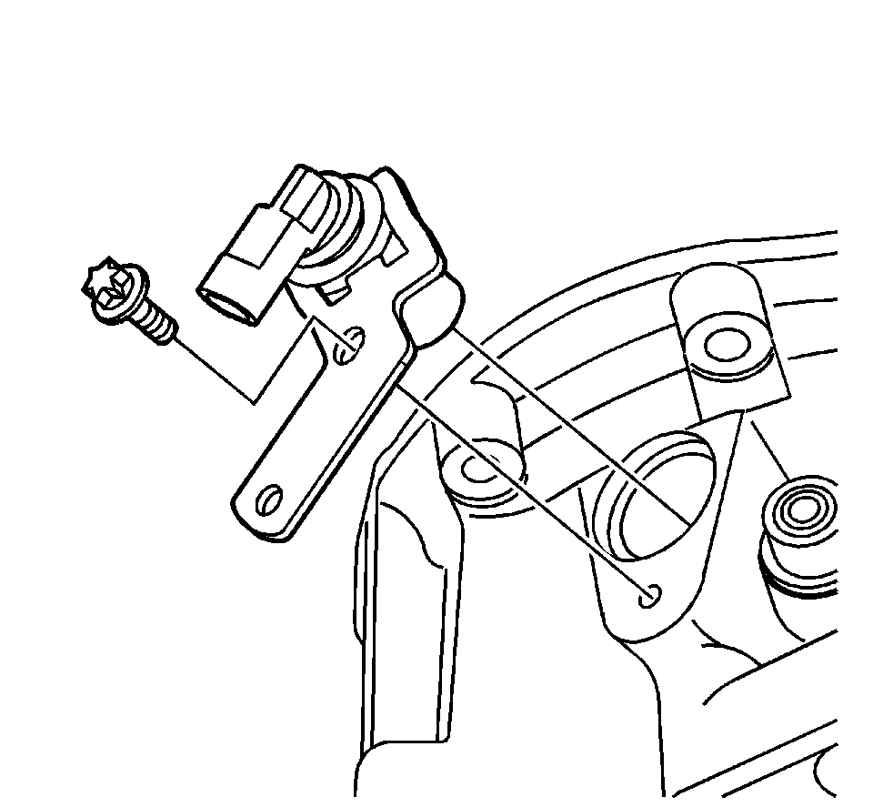

2005 Chevrolet Cobalt L4-2.2L VIN F
MU3
Procedures MU3
Vehicle Speed Sensor (VSS) Replacement
Removal Procedure
1. Remove the left front wheel.
pic 1
2. Disconnect the vehicle speed sensor (VSS) electrical connector (2).
pic 2
3. Remove the retainer bolt.
4. Remove the retainer.
5. Remove the VSS.
6. Remove and discard the O-ring.

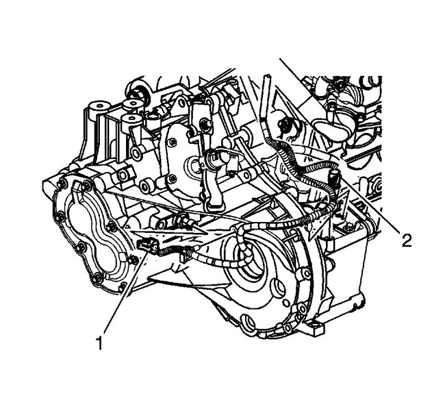

Installation Procedure
1. Lubricate a new O-ring with DEXRON III transmission fluid Saturn P/N 121019223.
2. Install the new O-ring.
pic 3
3. Install the VSS retainer.Install the vehicle speed sensor (VSS) assembly.
4. Notice: Refer to Fastener Notice in Service Precautions.
Install the VSS retainer bolt.
^ Tighten the bolt to 9 Nm (80 inch lbs.).
pic 4
5. Connect the VSS connector to the VSS (2).
6. Install the left front wheel.

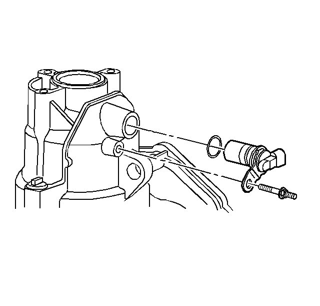

4T40-E/4T45-E
Removal Procedure
1. Caution: Refer to Battery Disconnect Caution in Service Precautions.
Disconnect the negative battery cable from the battery negative terminal.
2. Raise and support the vehicle.
3. Remove the electrical connector at the vehicle speed sensor.
pic 5
4. Remove the retaining stud and the sensor. Pull straight out in order to avoid damage to the case.
1. Clean and dry the vehicle speed sensor.
pic 6
2. Notice: Install the vehicle speed sensor and the retaining bolt.
^ Tighten the stud to 12 Nm (97 inch lbs.).
3. Install the electrical connector at the sensor.
4. Remove the safety stands.
5. Lower the vehicle.
6. Connect the negative battery cable.
^ Tighten the terminal bolt to 15 Nm (11 ft. lbs.).
