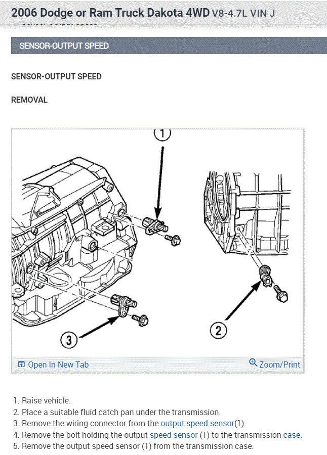

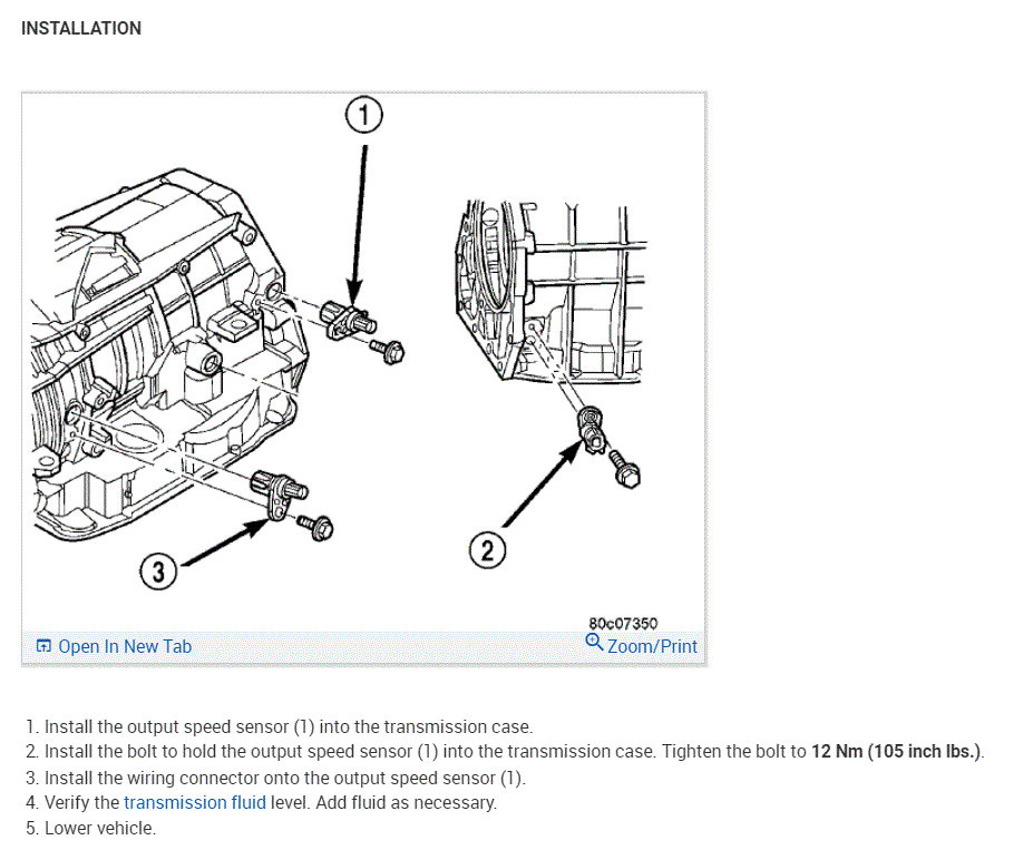

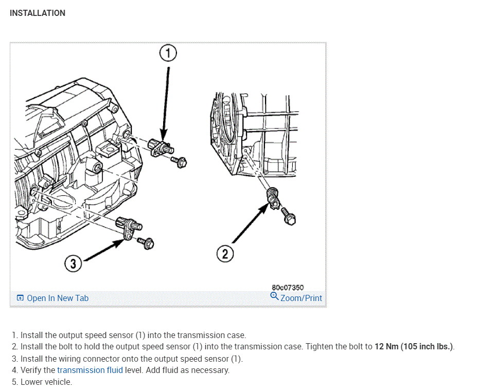

If you have the new part, I would install it to see if it helps. I attached the directions below for replacing it.

See pics below.
