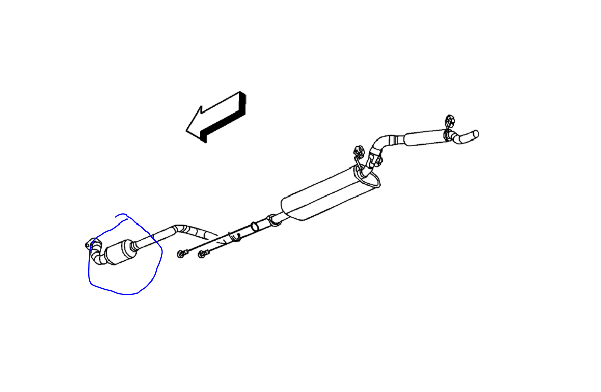

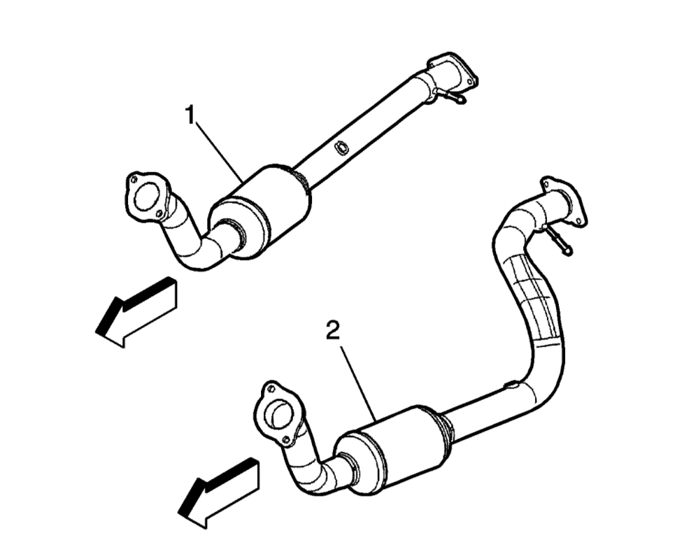

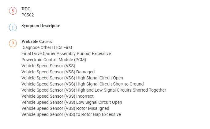

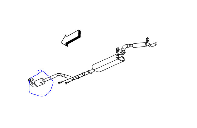

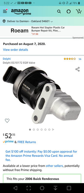

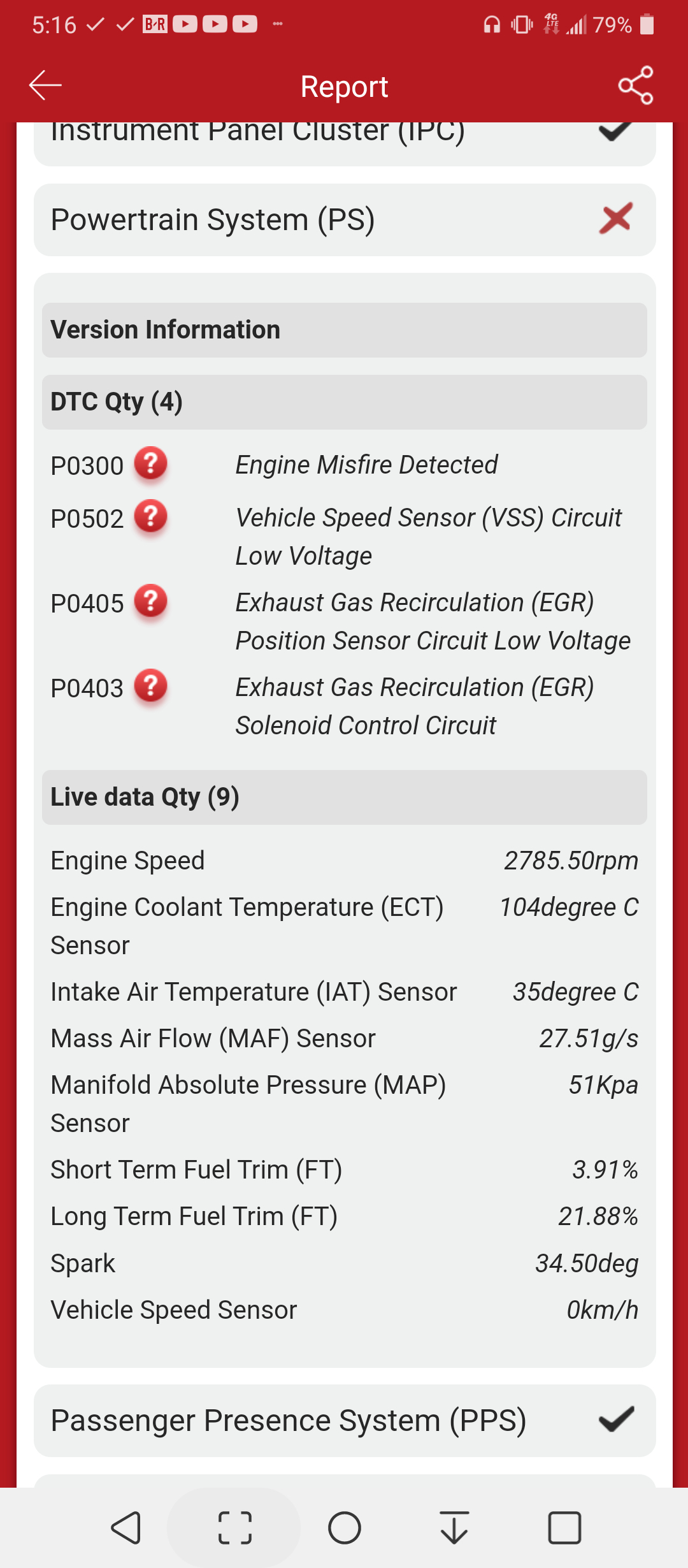

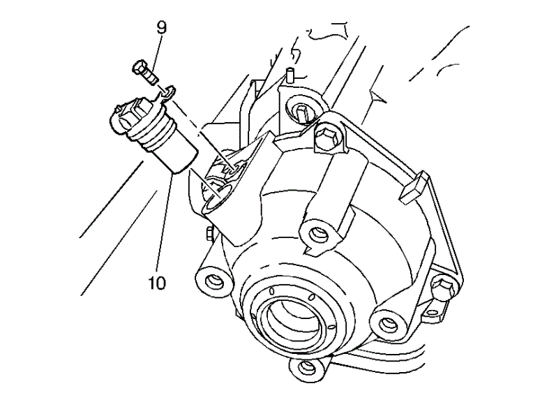

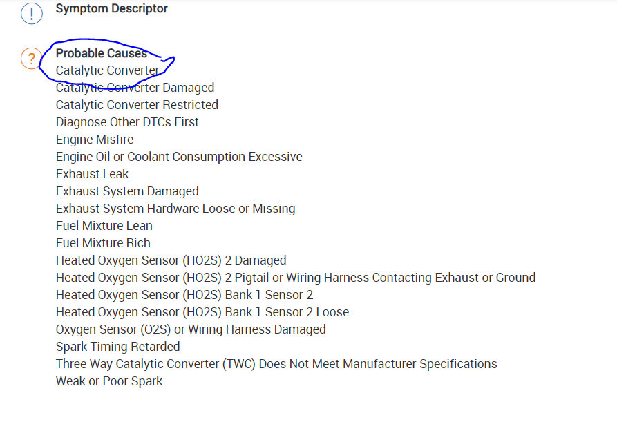

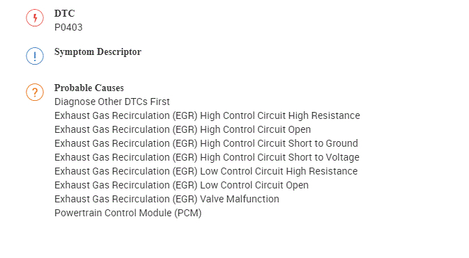

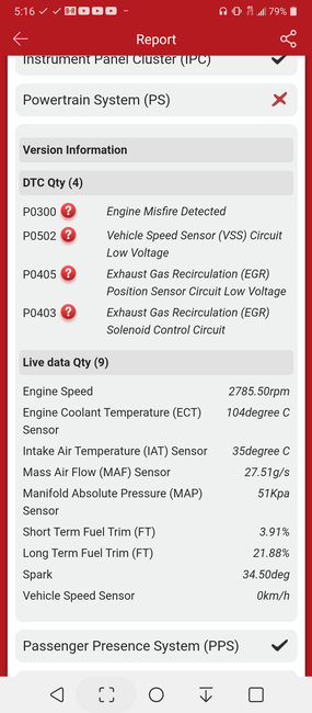

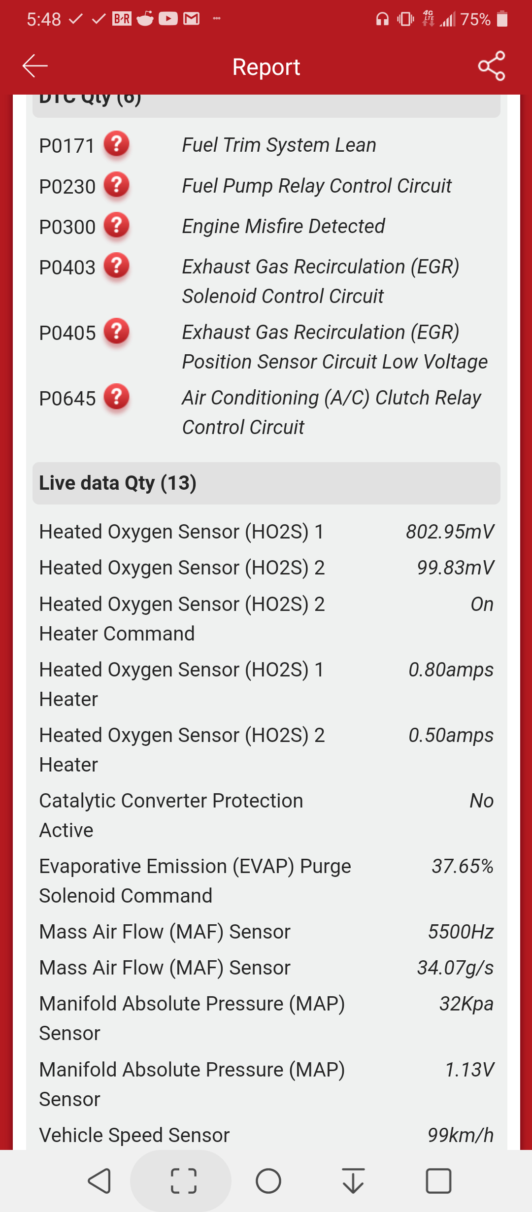

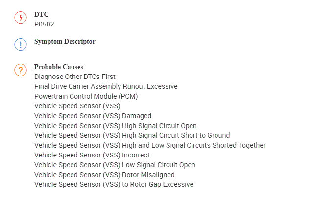

Code P0171. I have an O2 sensor for it (narrowed it down to that). Car runs really rough. Like its a large leak or something. Now after running the scanner, it said I had multiple issues..one was the EGR valve. I changed it and the new part was too small. I can't even put the plug back in correctly. Then the dealership said in the paper that he included with my car that the speed sensor was damaged. So I changed that but my car idled horribly after changing it and it wouldn't go past 30 mph. I changed it back to the old one and it runs better. Now the old one is giving me problems. I got a code for that as well. I noticed the old one has like a grease or something around the bottom when I took it out. Is it something that's supposed to be on there when you install it? I basically want to know what should I do about these issues? Mainly the speed sensor. Which isn't working correctly, the speedometer stops working and then it stalls in first.
