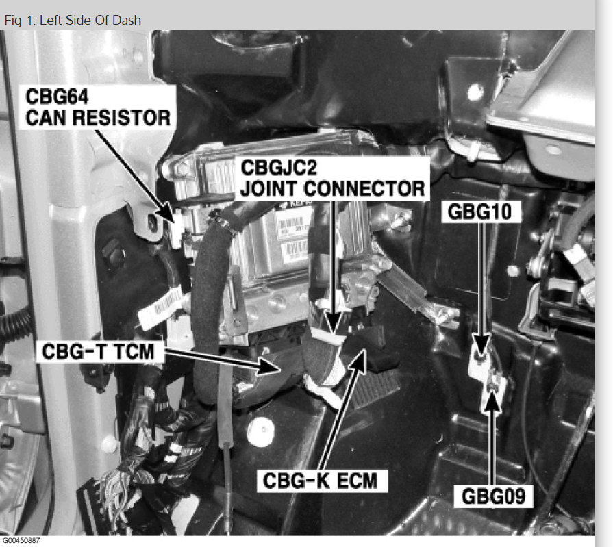

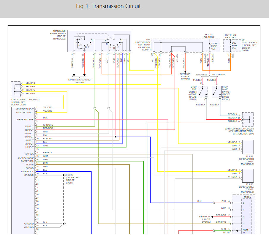

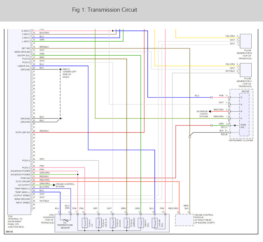

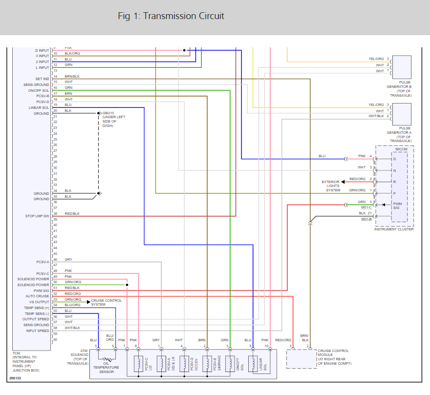

It sounds like the wiring from the speed sensors (pulse generators) or TCM module is out. here are wiring diagrams and a guide to help you test the wiring with the TCM location. I would check the electrical connector for corrosion before replacing it.
