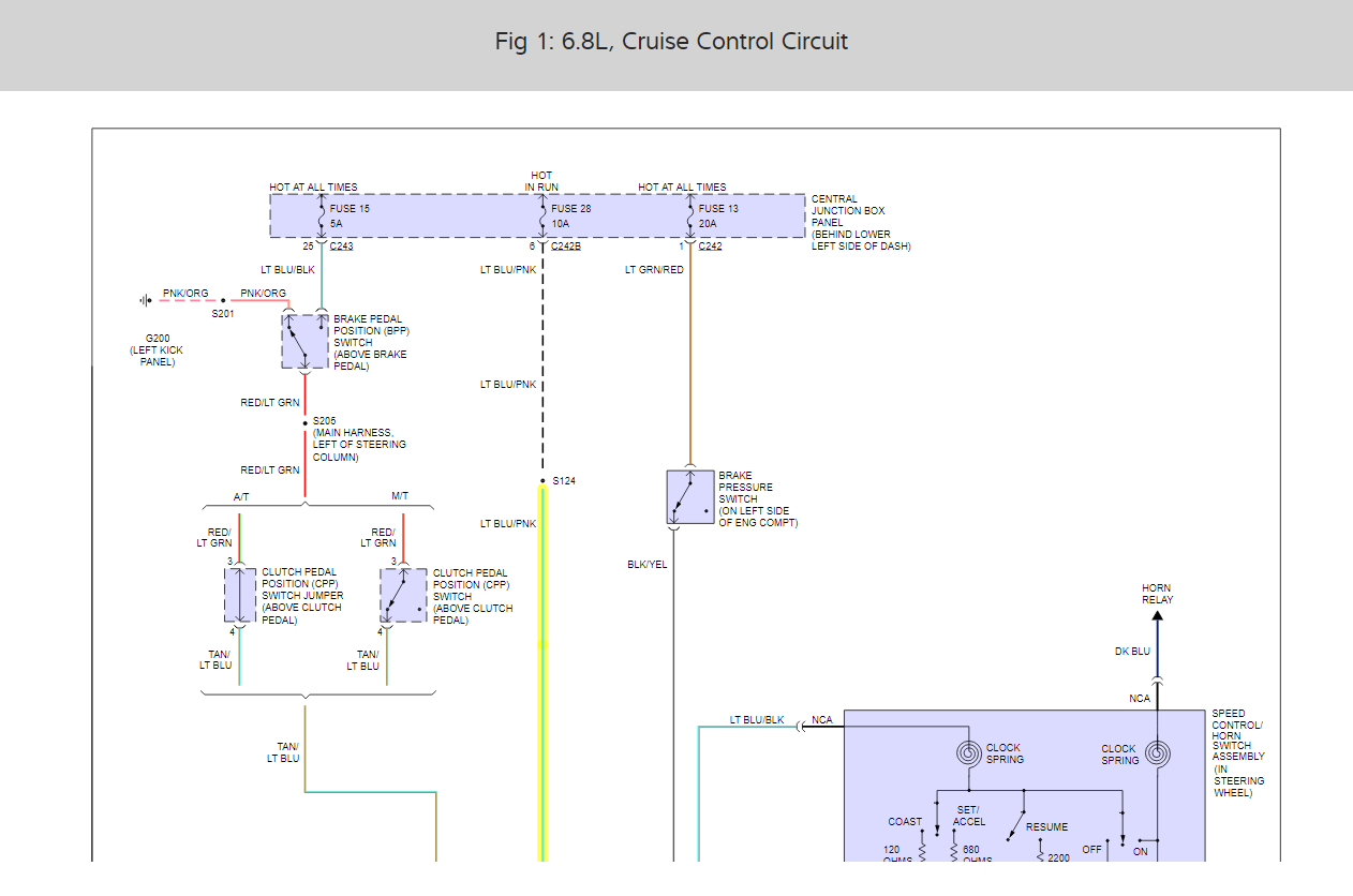

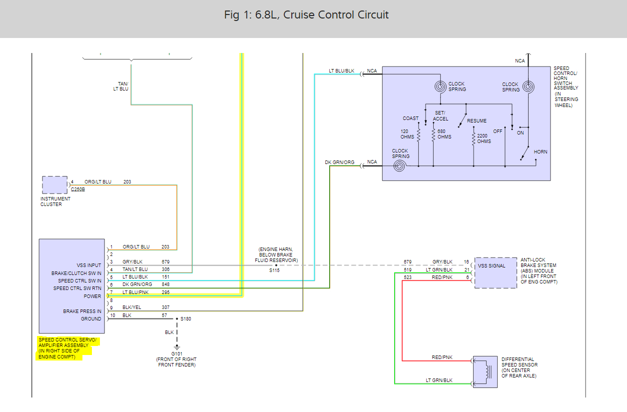

This truck super duty blows the number 28 fuse when you turn the key to on which causes the cruise control to not work. i don't know if it has a speed control module or if it runs off the OEM. I need to get it figured out ASAP. If it is not in the sensor what else could cause the fuse to blow? If its a short where would the best place to start looking for it be?
