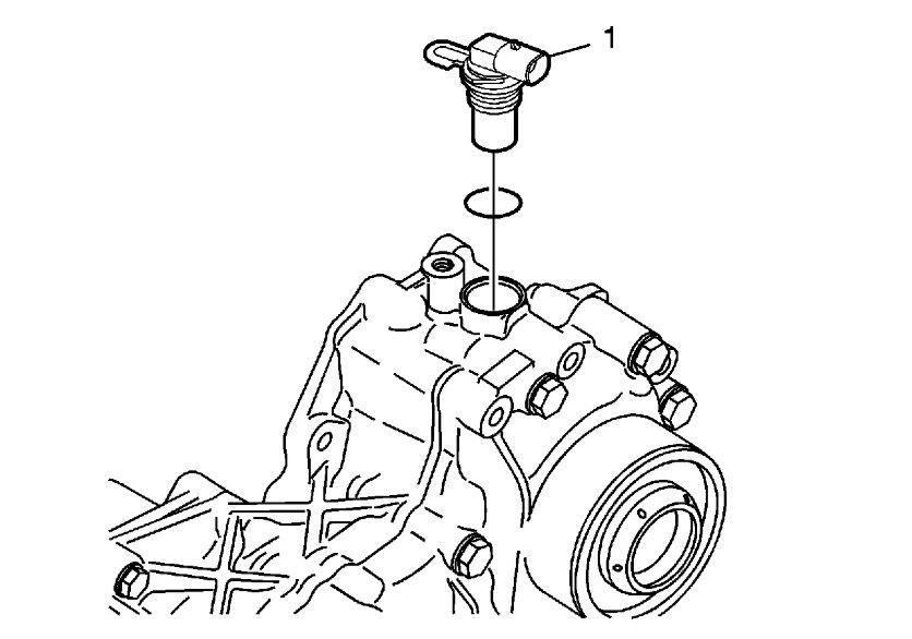

There is a sensor on the transmission that controls the speedometer. It is a common failure.

Okay.
Then you will need an advanced scan tool to see if the signal from the sensor is reaching the PCM. If the signal is getting there then it is the instrument cluster is the issue.
If there is no signal then it may be the sensor not sending the signal.
