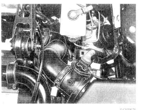

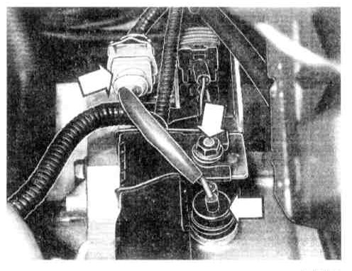

It sounds like you have a vehicle speed sensor that is going out which runs the speedometer. Here is a diagram (below) of its location so you can replace it to fix the problem.
