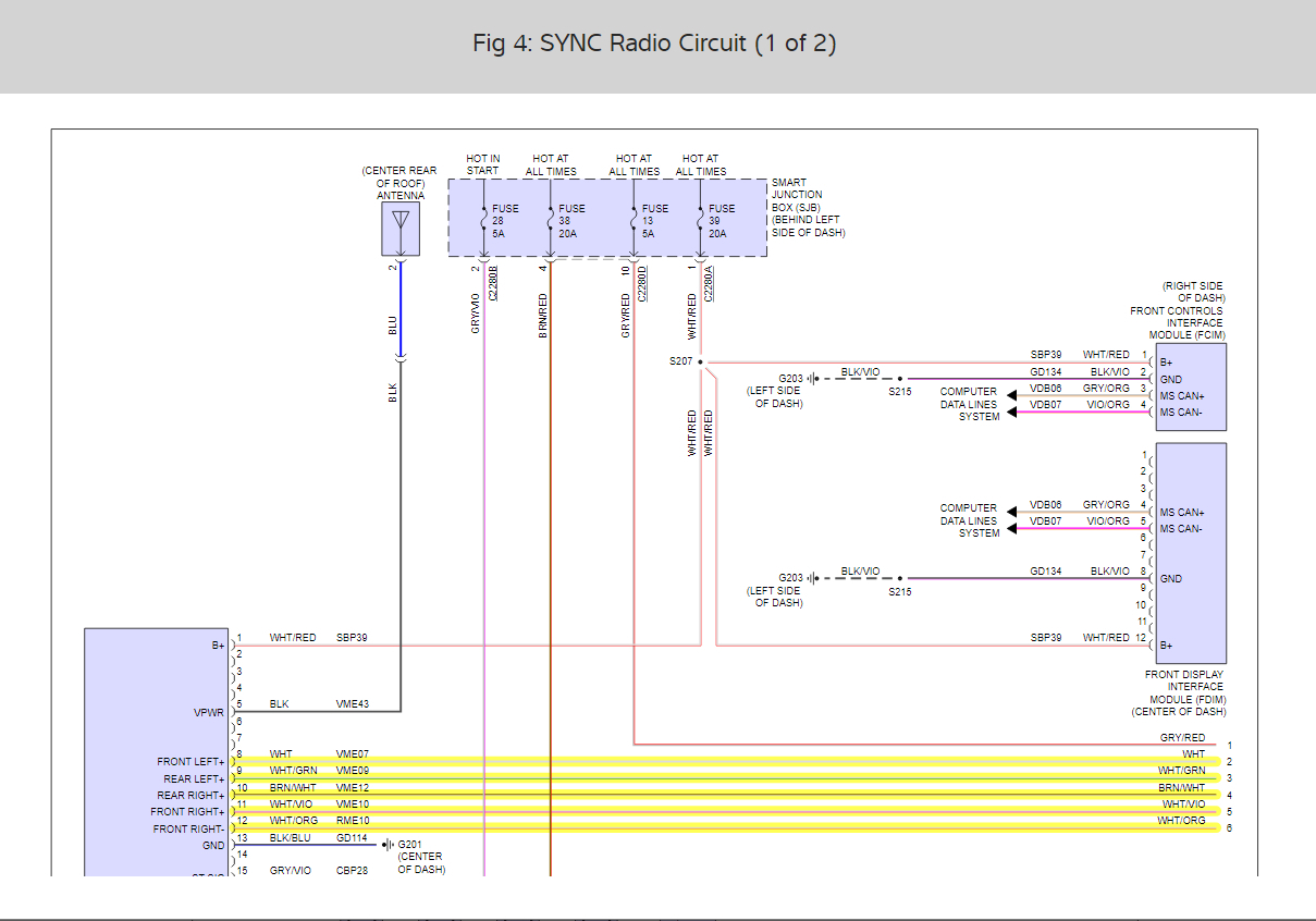

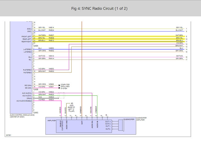

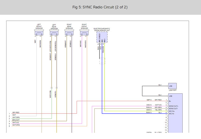

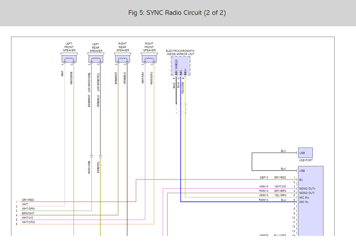

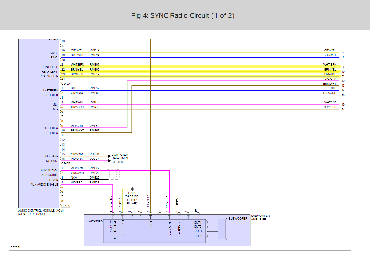

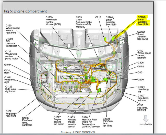

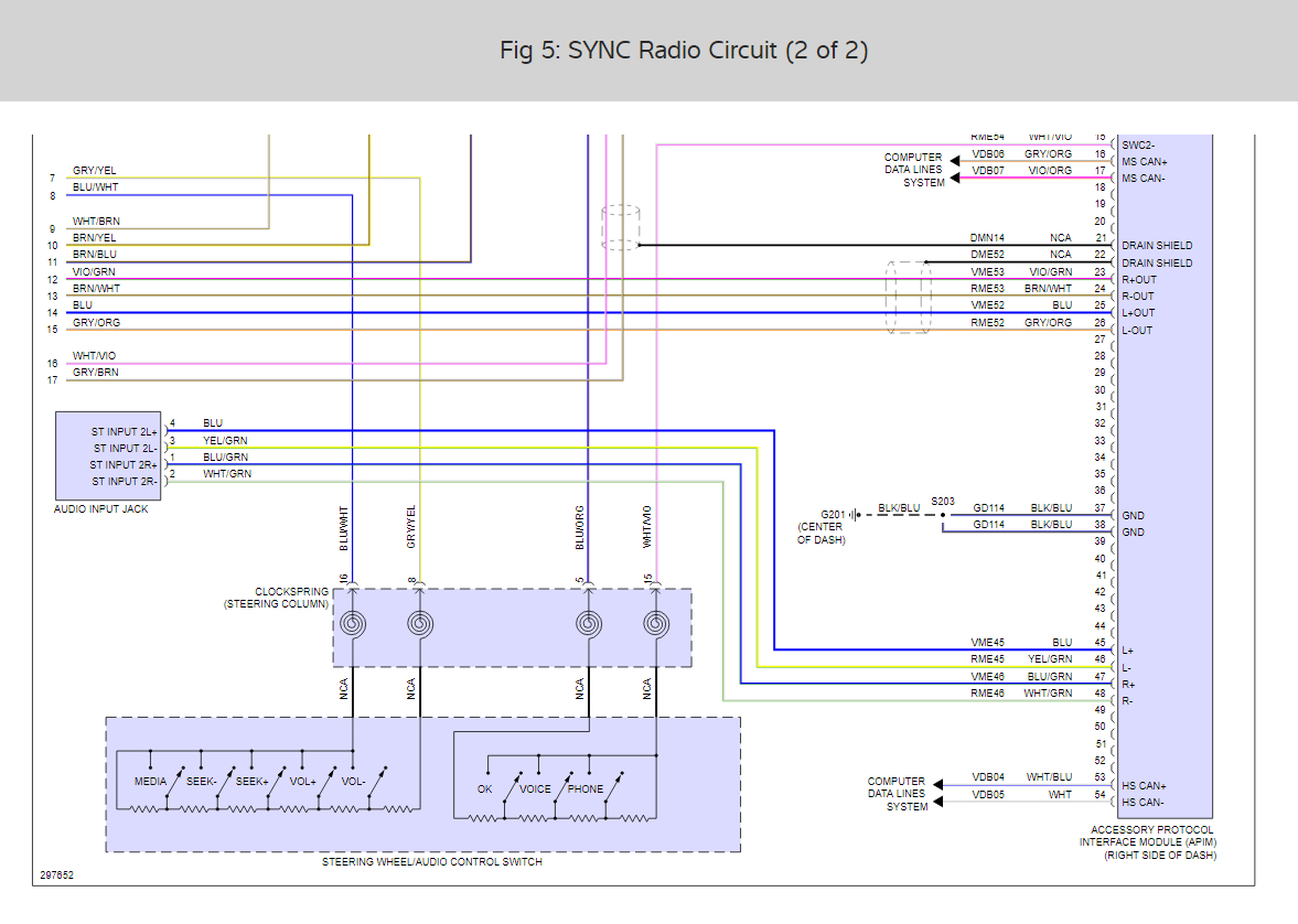

Hello again,
In the diagrams down below I have included the wiring diagram for your vehicle's radio. Please ensure that the highlighted wires on the wiring diagram are connected in the connector and that the connector is good and tight. You also want to check that the antenna wire is connected good and tight as well. Please get back to us with what you find out.
Thanks,
Alex
2CarPros
Jun 15, 2019 at 1:25 PM
ROBERT CARPENTER
  • 6 POSTS
Thank you! Everything seems to be connected well and tight.

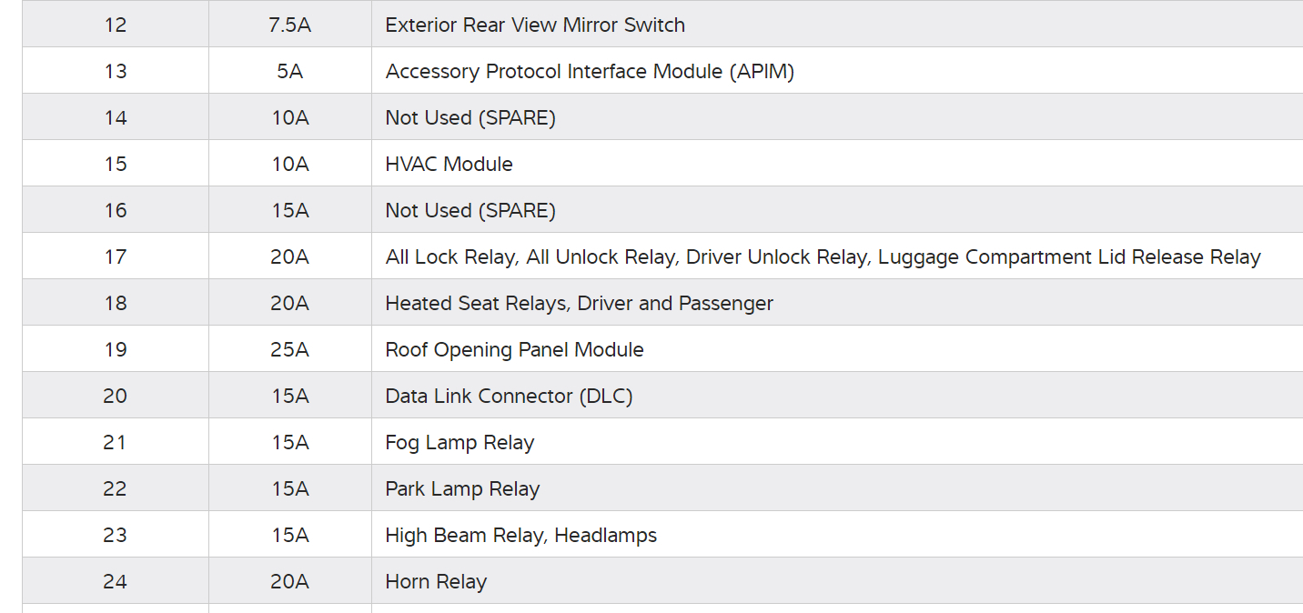

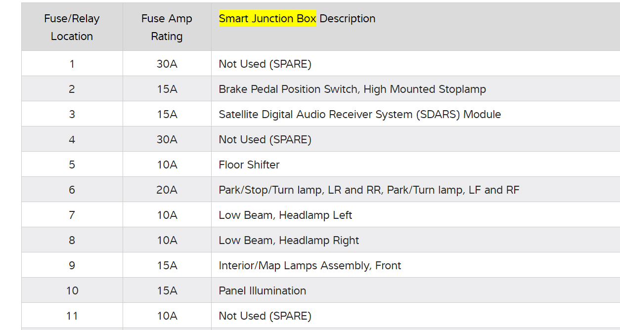

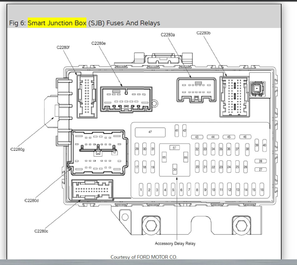

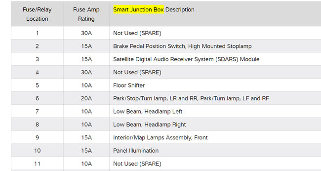

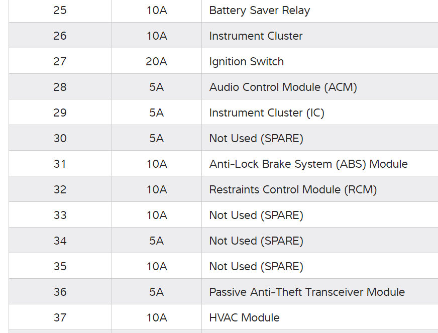

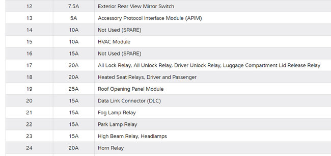

No still isn't working. Is there a fuse that I'm not aware of that could be blown?
Jun 17, 2019 at 4:51 PM
SCGRANTURISMO
  • 4,897 POSTS

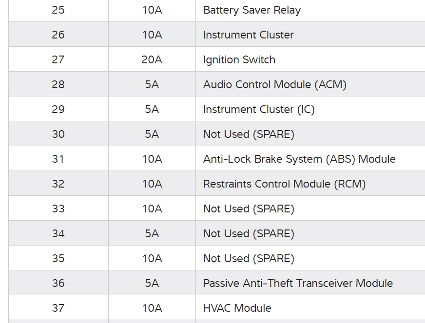

Hello again,

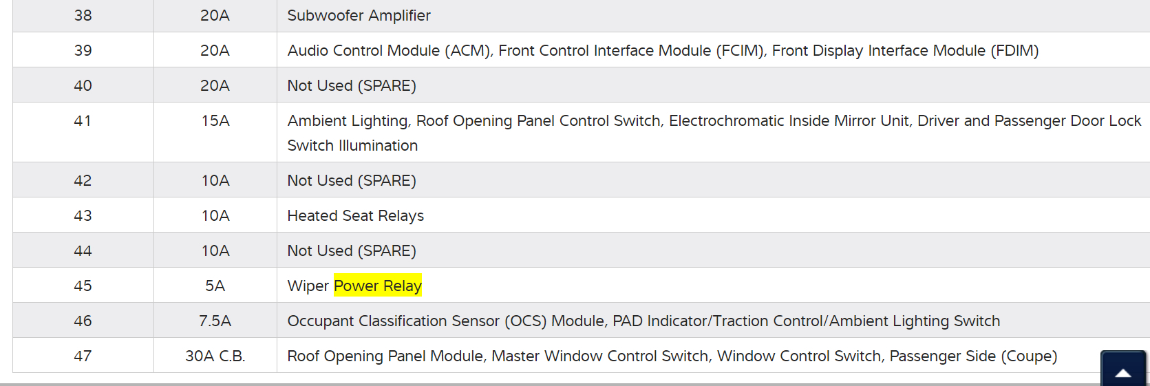

In the diagrams down below I have included a diagram of the Smart Junction Box which is under the left side of the dash. The fuses that control your stereo are fuse #28,38,13,39. Check these fuses and get back to us with what you find out.

Thank you! I'll check it out later. Is there a amp fuse, if so wheres it's location?
Jun 18, 2019 at 9:28 AM
SCGRANTURISMO
  • 4,897 POSTS
Hello again,
Yes there is. It is fuse #38(20A)(Subwoofer Amplifier) in the information that I sent earlier.
