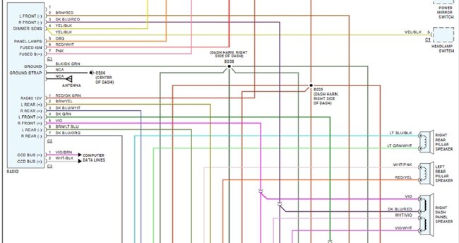

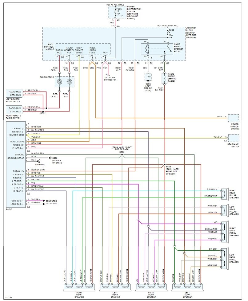

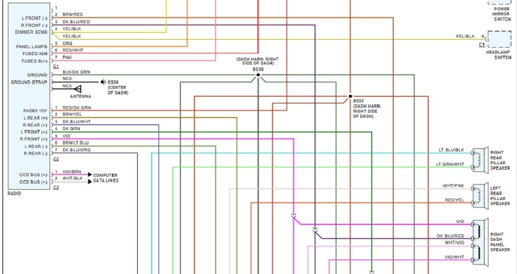

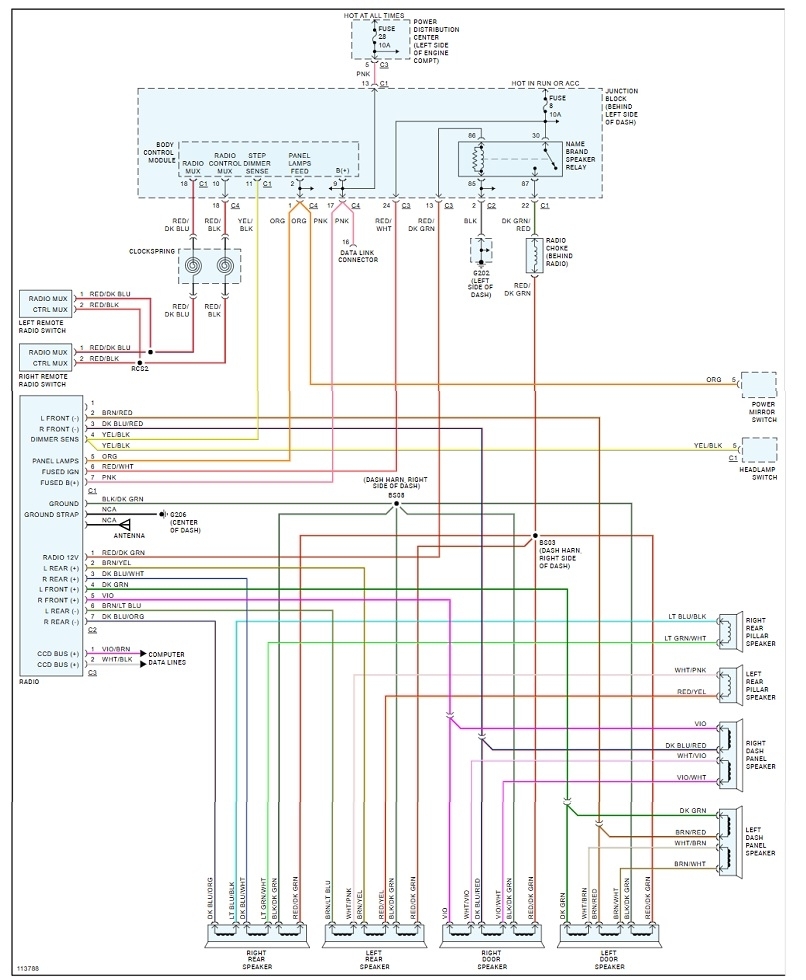

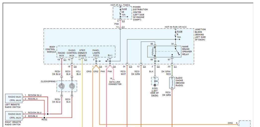

Remember too, if an original speaker can be reinstalled, there were two versions, one with the built-in amp and one without. Either one will develop the same volume when used with or without your aftermarket amplifier. The tone response would normally be the issue, but aftermarket amplifiers do not change the tone for the shape of the vehicle. Chrysler makes those adjustments in their factory amplifiers. Ford and GM do that in their radio head units. Aftermarket radios and amplifiers are a one-size-fits-all. None of them are designed specifically for one car model.

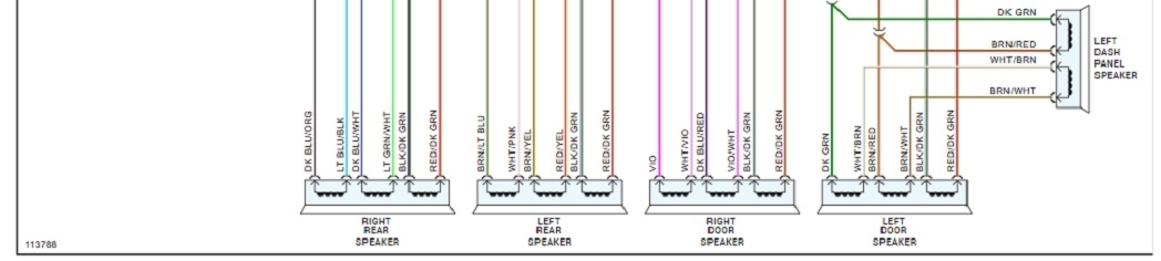

Since we don't know what kind of speaker arrangement the aftermarket system uses, keep in mind, the original speakers in the doors were a woofer and a tweeter together in one unit, and in this application, the tweeter was in series with a speaker in the rear. Your aftermarket amplifier will run the woofer okay, but the tweeter will be too loud. I suspect any aftermarket speaker will sound better with the aftermarket amp. Being a non-factory system, it is likely the rear speaker isn't being used in series with the door speaker.
Another thing to be aware of is often a single speaker is not meant to "sound right". Tweeters, for example, are often mounted in "A" pillars next to the windshield, or next to side mirrors. They sound really tinny by themselves, but they make the entire system sound very nice. Same with woofers in doors. The large door cavities do a very poor job with tweeters. High notes also tend to travel in more of a straight line, so you won't hear them as well when they come from a door speaker. You have to look at the entire channel as a whole, and pay less attention to any one individual speaker. What you think "sounds like in a tunnel", from the one speaker might sound okay while driving.
I know I'm making this unnecessarily complicated. Perhaps a better place to start, since you said only one speaker is missing, is to install the one you still have on the other side, and make sure that one sounds right. If one side sounds good now with the original speaker, replace just the one with a new 6x9, then compare how that side sounds. If it's okay, it should sound the same with the new speaker on the other side. Listen to both sides the same way. If you have your ear down by the door speaker, compare both sides the same way.
