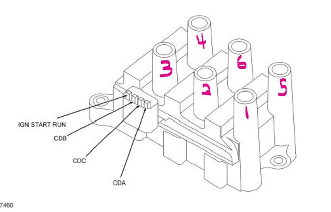

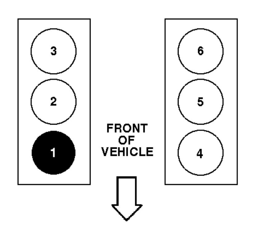

Wiring diagram for spark plugs.
Feb 26, 2023 at 2:51 PM
STEVE W.
CERTIFIED EXPERT
15,116 POSTS
This is the cylinder locations and the plug wire locations on the coil. Be sure where the electrical connector is.
