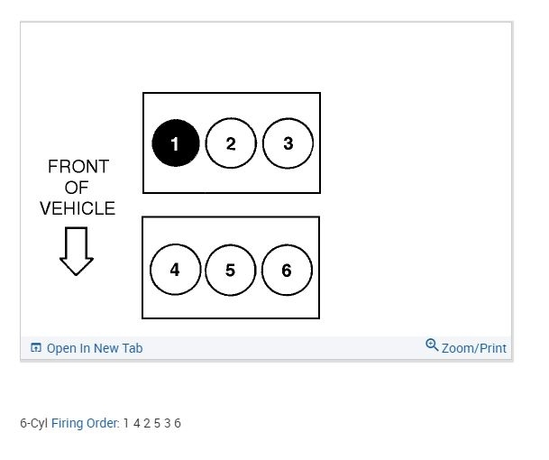

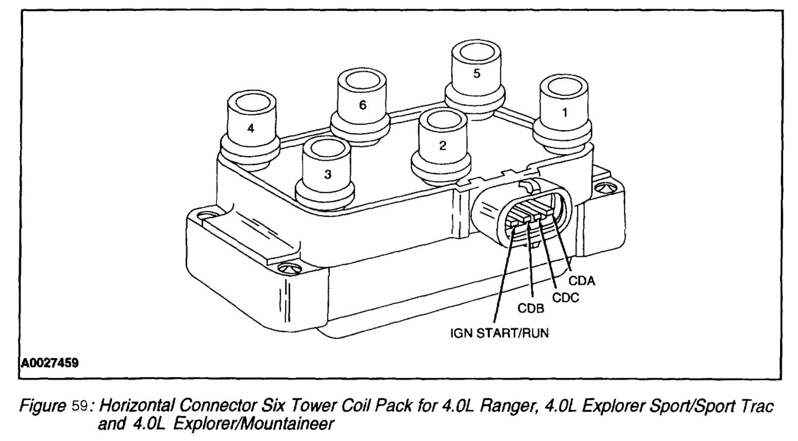

I have the car listed above, LS premium. I need the spark plugs firing order. Thanks
Mar 14, 2022 at 11:59 PM
CERTIFIED EXPERT
52,796 POSTS
Good morning,
I attached the firing order of the motor and the wire set up for the coil. Let me know if you have any other questions. Check out the diagrams (Below). Let us know what happens and please upload pictures or videos of the problem.
