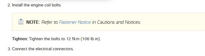

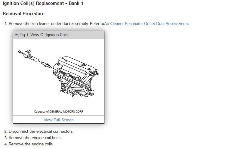

Well the instructions from Saturn are a bit simplistic. They say step (1) remove ignition coils. Step (2) remove spark plugs. Step (3) install new plugs. Step (4) install coils.
The instructions for removing the coils on Bank 1 (the front side) are in the images.

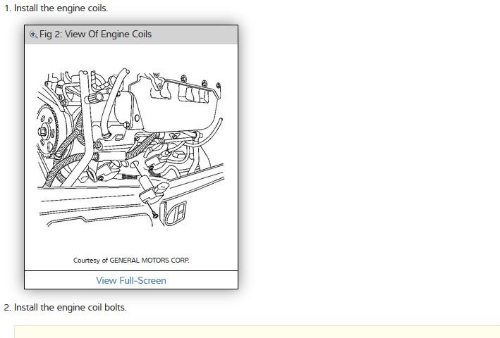

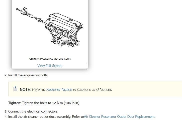

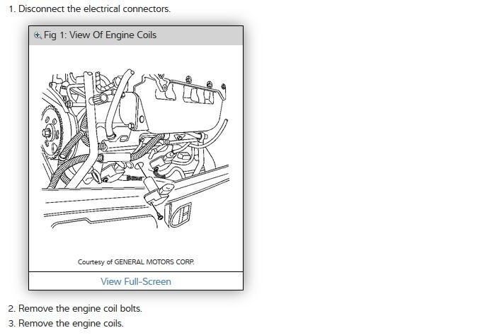

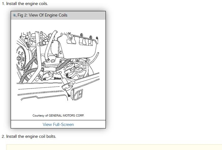

Bank 2:
