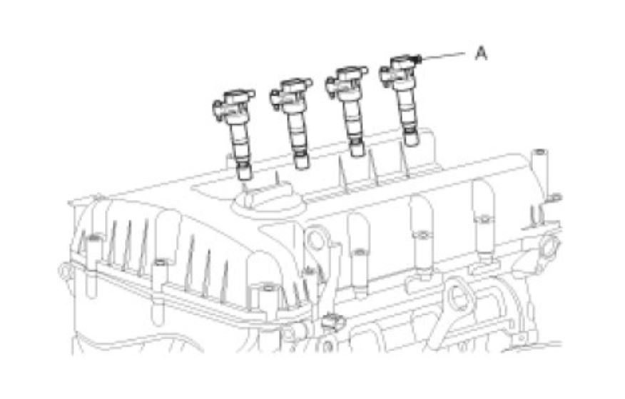

JJSTELM
I was watching your video on spark plugs for this vehicle. Is there anything I should unplug or detach that is electrical within the car before doing spark plugs? Such as a battery, sensors, etc. and if I disconnect the battery should I only take the negative off or the positive terminal as well? Just trying to be precautious. Thanks!
Apr 25, 2019 at 1:05 AM
Good morning,
No special items to disconnect. No need to remove the battery cable as well. Here is a guide to help with diagrams below to show you how on your car.
https://www.2carpros.com/articles/how-to-change-spark-plugs
Apr 25, 2019 at 4:07 AM
