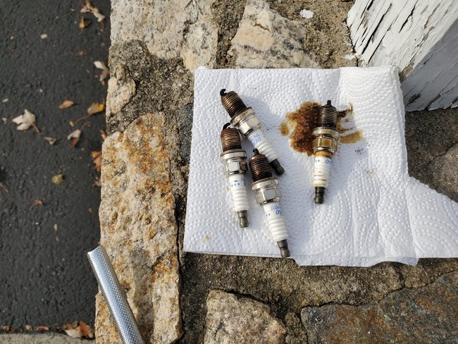

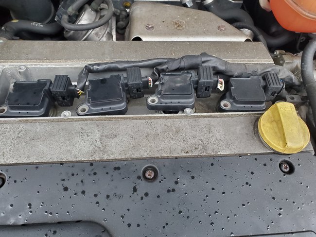

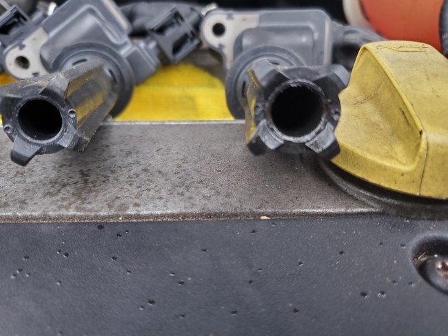

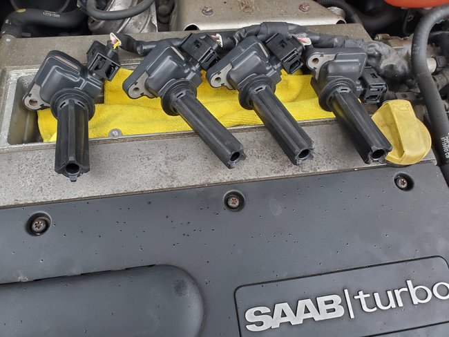

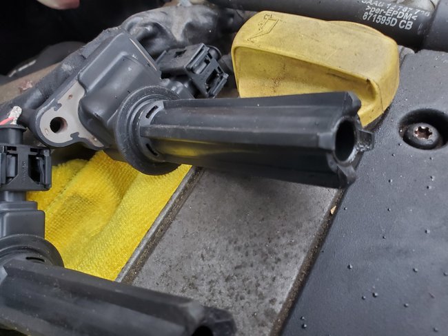

okay, that wet plug looks like its soaked in oil to me from the picture. So yes, you'll have to replace the valve cover gasket and the 4 O-rings. Then install the new spark plugs. You can either send a picture of the bottom of the coil that had the oil-soaked spark plug. or purchase another coil.
If the coil looks like the other coils, no noticeable differences, you can try it and see if the car still misfires. If it does, then replace that coil too. The valve cover gaskets are very easy to do. The O-rings are replaced from the inside of the valve cover when you get it off. Saab actually calls it a Camshaft cover, but it's the same thing.

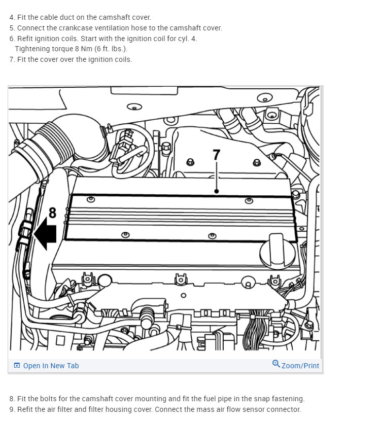

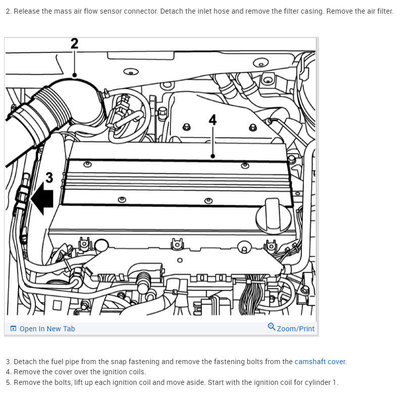

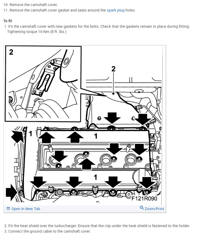

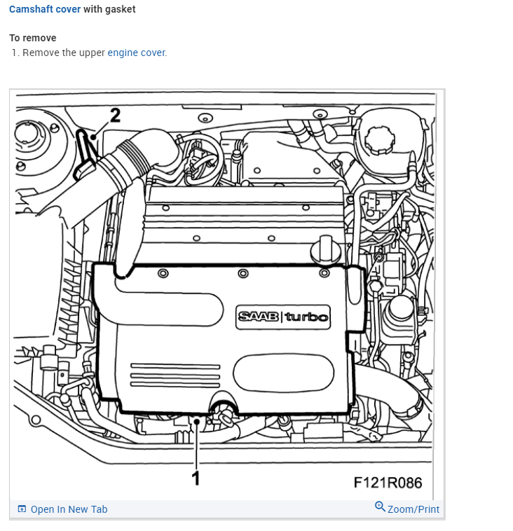

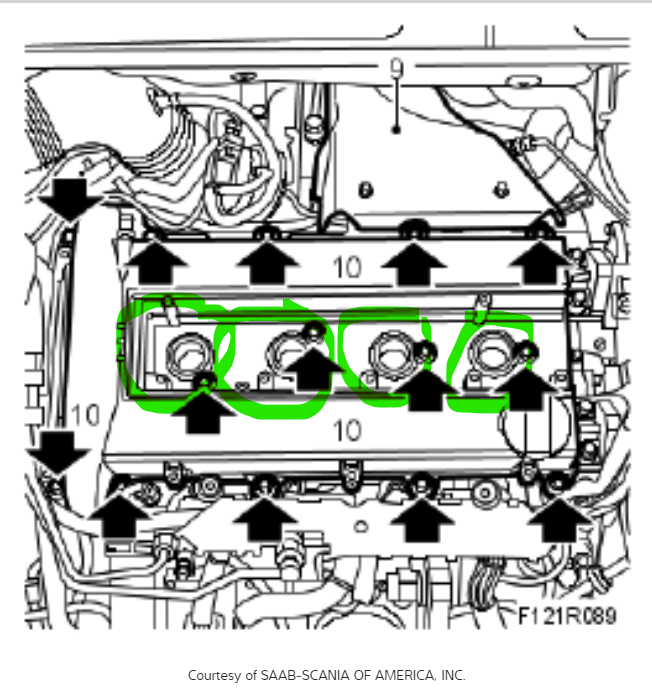

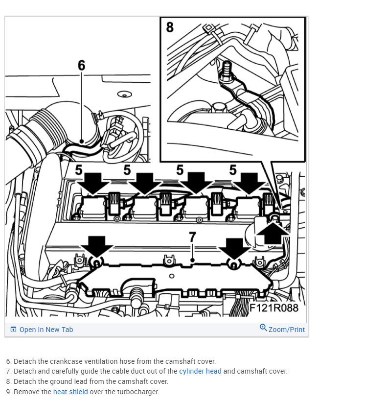

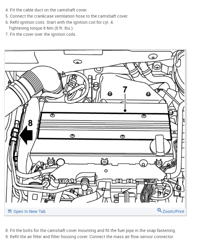

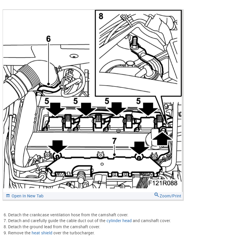

After reinstalling the valve cover, the install the spark plugs and torque them in. It's a good practice to check the gap on the spark plugs before installing them. The gap spec is with the torque spec for the spark plugs. The first six diagrams are for the valve cover (camshaft cover).

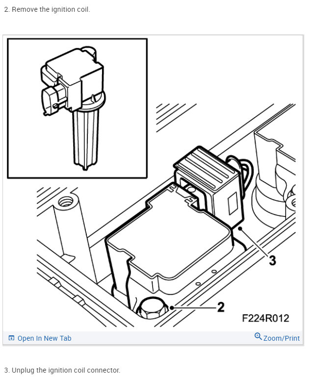

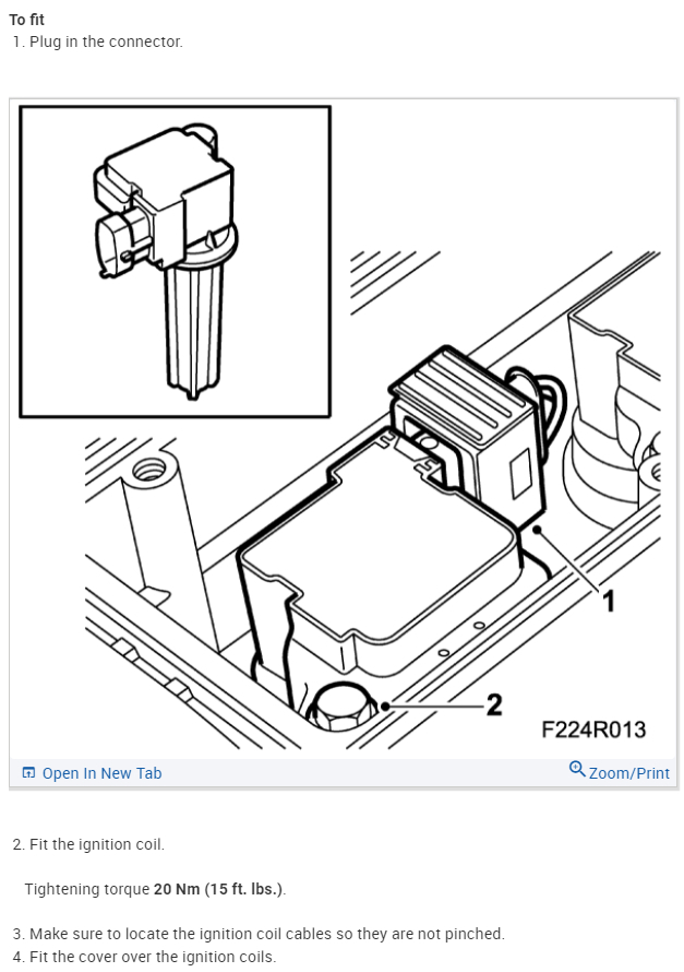

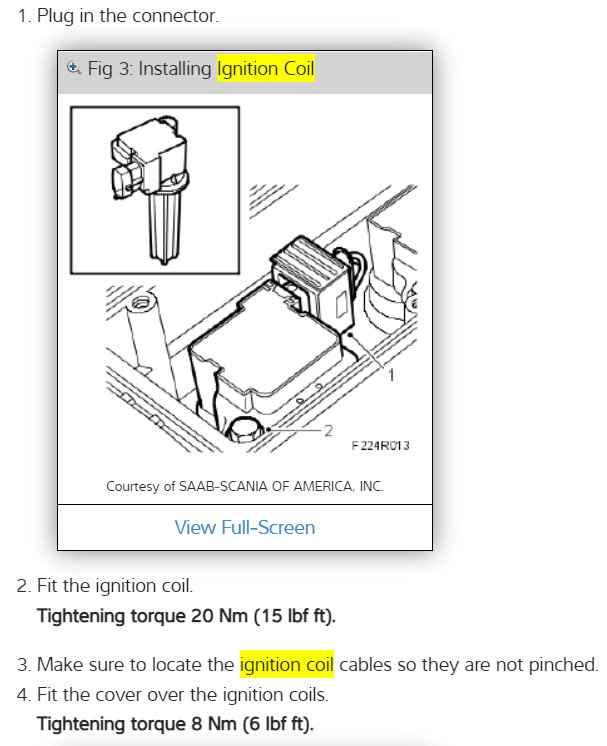

Next install the coils (seventh diagram) push them down on top of the spark plugs, plug the coil harness plug into the coils and install the hold-down bolt and torque to 15Lb ft.

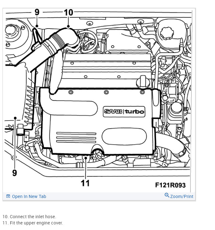

Then reinstall the ignition coil cover.

If you are worried about the coil that had the oil on top of the spark plug, you can replace that.
