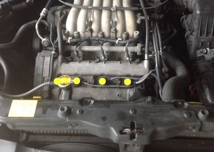

Where are the spark plugs located?

They are hiding under the spark plug boots on the top of the engine. See the attached picture. Those covers are removed and the plugs are in the pocket under them. You need a plug socket and an extension to reach them.
