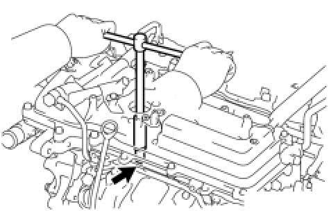

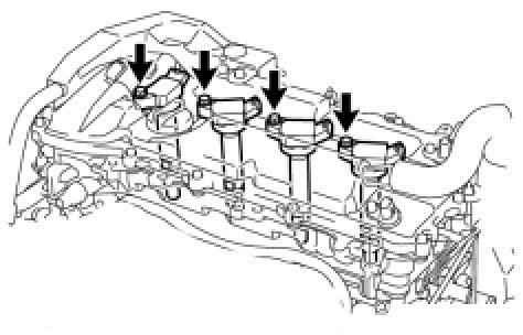

REMOVE NO. 1 ENGINE COVER SUB-ASSEMBLY
To remove cover, Lift the rear of the engine cover to detach the cover from the 2 pins, and then lift the front of the engine cover to detach the cover from the pin and remove the engine cover. See pic 3 below.

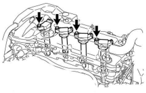

REMOVE IGNITION COIL ASSEMBLY
(a) Disconnect the 4 ignition coil assembly connectors.
(b) Remove the 4 bolts and 4 ignition coil assemblies.

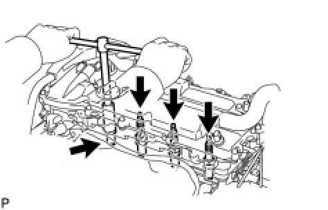

REMOVE SPARK PLUG
(a) Using a spark plug wrench, remove the 4 spark plugs.
Replacement is the reverse of removal.

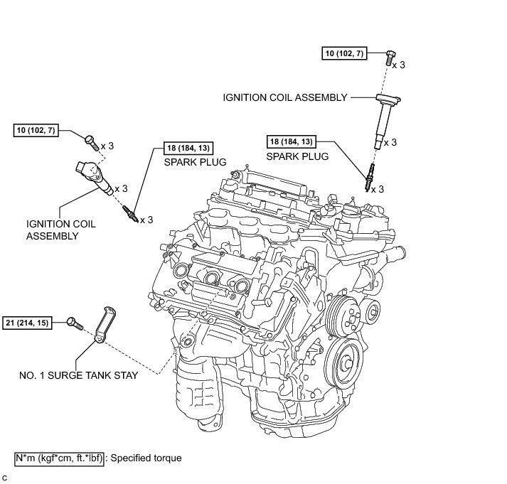

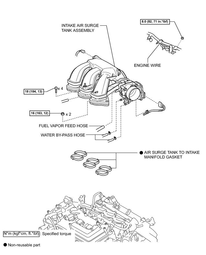

For 6 cylinder engines, the air intake must be removed to access the spark plugs. This is a more difficult task. However, take your time and follow these directions.
REMOVE INTAKE AIR SURGE TANK ASSEMBLY
REMOVE NO. 1 SURGE TANK STAY

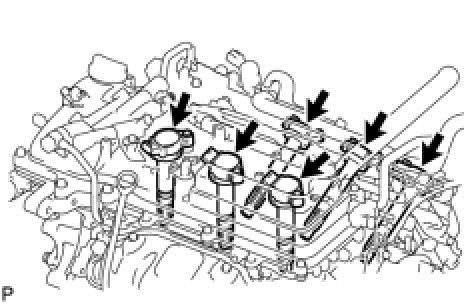

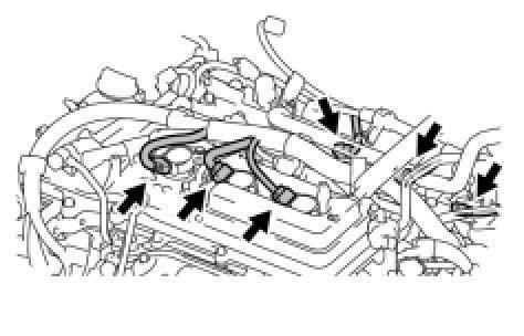

(a) Remove the nut.
(b) Disconnect the 2 harness clamps.
(c) Disconnect the 6 ignition coil connectors.
(d) Remove the 6 bolts and 6 ignition coils.

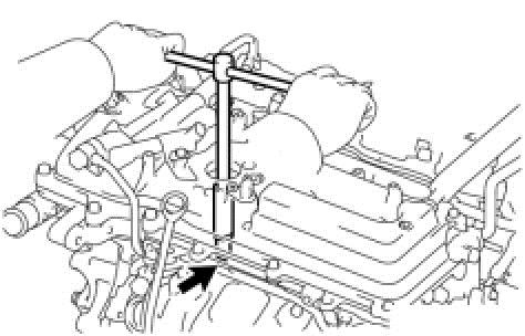

REMOVE SPARK PLUG
(a) Remove the 6 spark plugs.
As mentioned, this is more involved. Pictures 4 through 10 are related the 6 cylinder engine.
