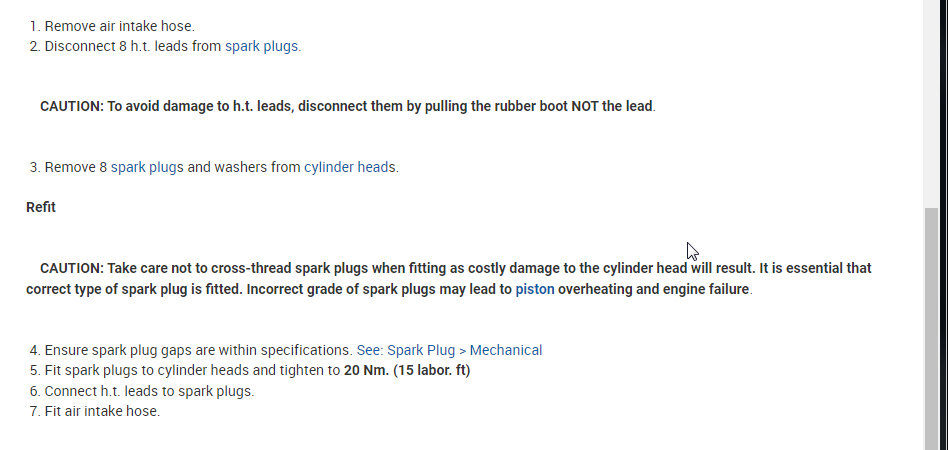

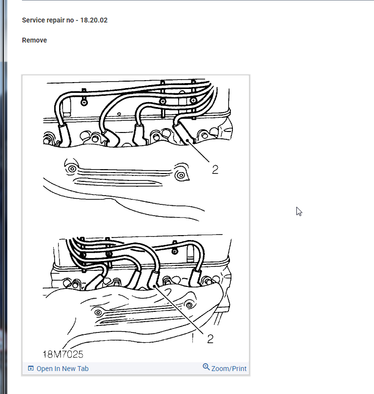

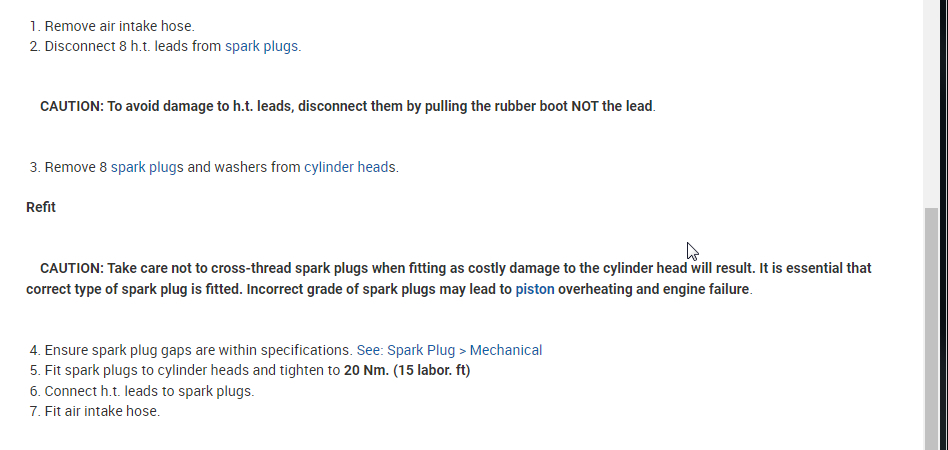

Below is the process from the manual of a like vehicle. Unfortunately we don't have a manual on this vehicle so I can't provide the specifics but this material should get you what you need to replace these plugs. Thanks
