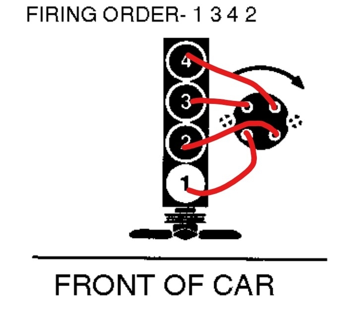

Need a spark plug wiring diagram to the motor.

The firing order is 1-3-4-2 clockwise. Number one on the cap is usually the front left tower on the distributor.
