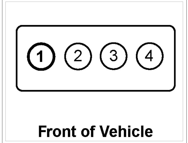

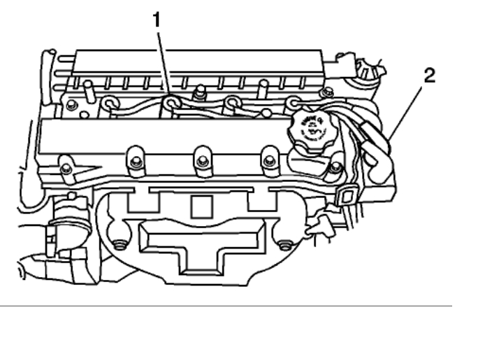

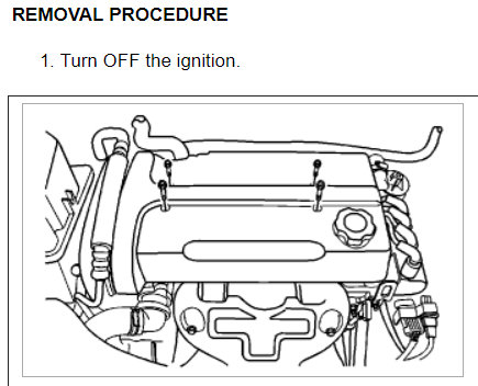

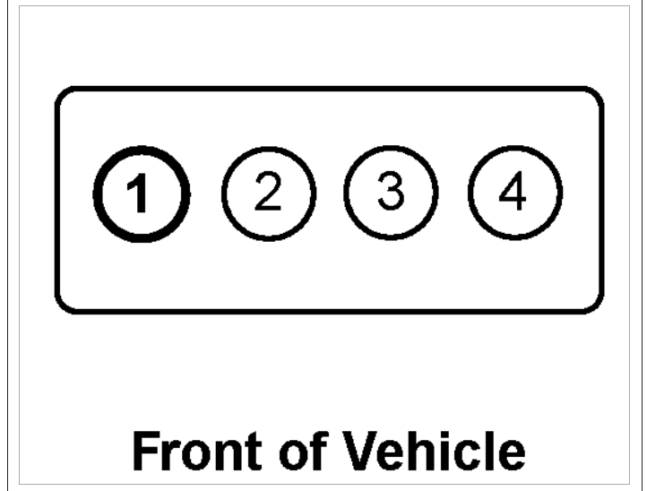

Spark plug wires were removed and not sure of firing order they go.
Jan 2, 2018 at 8:02 AM
Here is the firing order:
Firing order 1-3-4-2.
Check out the diagrams (below).
