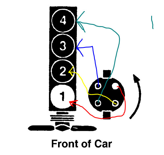

The firing order is 1, 3, 4, 2.
If you look below, I made a diagram for you showing how the plug wires should be positioned between the distributor cap and the spark plugs.
Please keep in mind, if the distributor has been changed, you really should check the timing to make sure it isn't too far advanced or retarded.
Take a look at the pic (sorry it looks like a child made it). I'm not good at making pics with a computer mouse. LOL Let me know if this helps or if you have other questions.
See pic below.

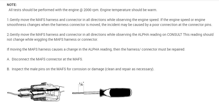

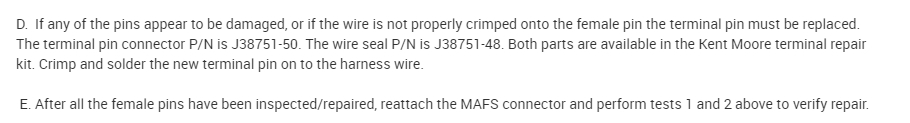

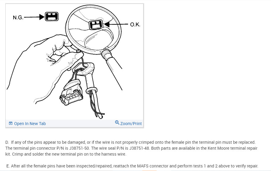

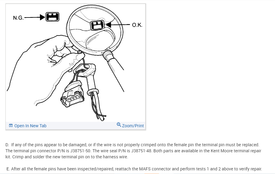

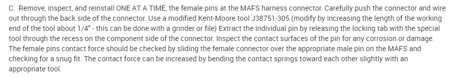

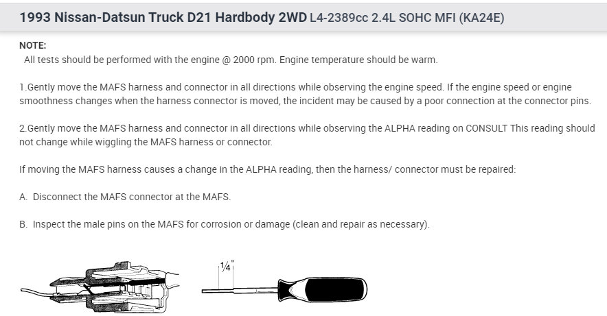

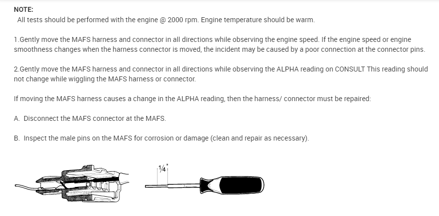

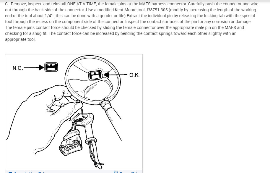

Also, if you look below, it explains how to test a MAF for code 45. This is from a technical service bulletin.

Chances are the sensor is faulty. However, I did find a technical service bulletin related to it. Take a look at the attached pics below. They describe what to check when there is a code 45.
Let me know what you find.
See pic below.
