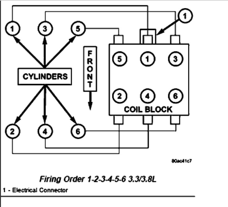

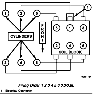

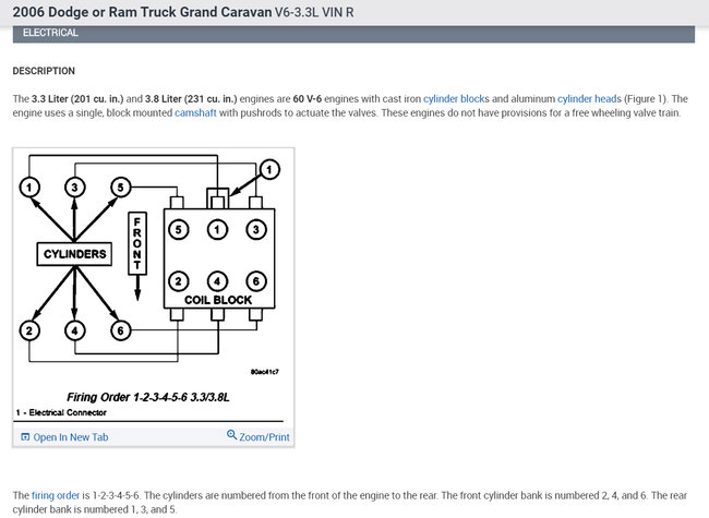

I see on this website under questions you have answered, a chart for a 2005 Dodge Caravan for the spark plug wires. I have the van listed above it is a MFI OHV. Would I use the same chart for changing the wires? I already took off the old wires, but did not know that I should have done them one at a time, or that the order mattered. So I am looking for the right order.
Nov 15, 2017 at 2:03 PM
PATENTED_REPAIR_PRO
  • 1,853 POSTS
Here is that firing order:

The engine ignition firing order is
Firing Order 1-2-3-4-5-6
The cylinders are numbered from the front of the engine to the rear. The front cylinder bank is numbered 2, 4, 6. The rear cylinder bank is numbered 1, 3, 5.

WULVE50
I need to know the firing order so I can re-attach the spark plug wires in the right order. It is a 3.3 liter six cylinder.

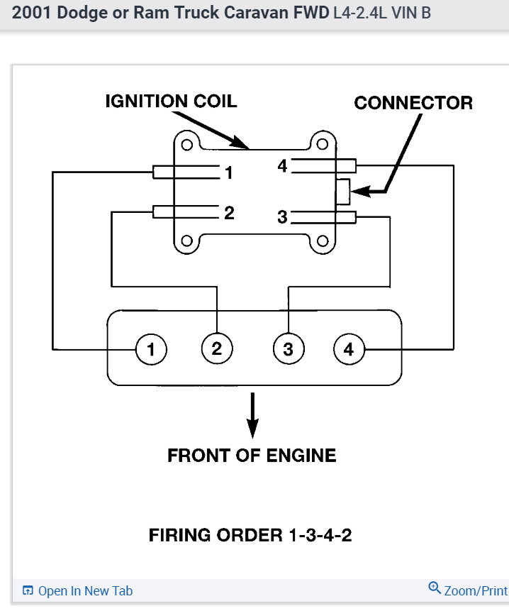

Here is the engine ignition firing order to help you get back on the road the four cylinder diagram is below
https://www.2carpros.com/forum/automotive_pictures/261618_Graphic_488.jpg
Check out the diagrams (Below). Please let us know if you need anything else to get the problem fixed. Cheers

what is the firing order for a 3.3 litre V6?
Jun 20, 2020 at 10:49 AM (Merged)
Here is the engine ignition system firing order in the diagrams below. Check out the diagrams (Below). Please let us know if you need anything else to get the problem fixed.
