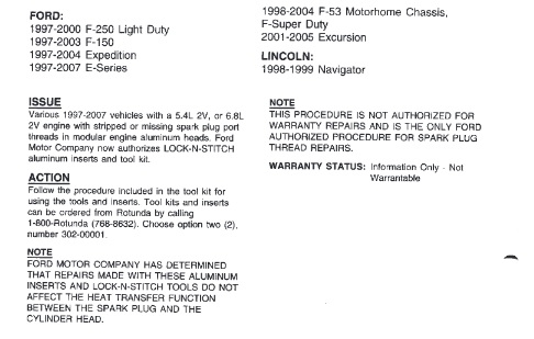

A neighbor wants his spark plugs and coils changed and he wants me to tap the cylinder eight. Changing out the plugs and coils seems not so difficult but what does he mean by tap the cylinder eight? And how would I go about doing that?
