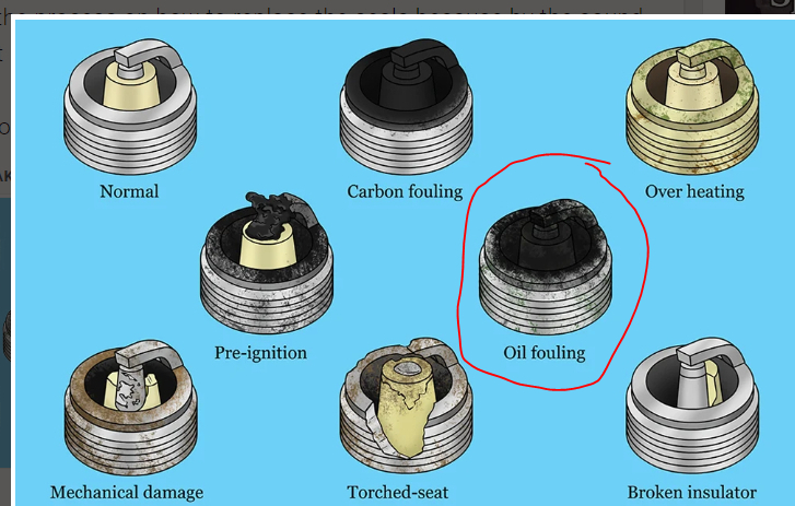

If you remove the spark plug, does it appear to be oil-fouled? Also, any blue smoke from the exhaust? Is the misfire only cylinder 4?
Take a look at the picture and let me know if that is what the plug looks like.
See pic below.
