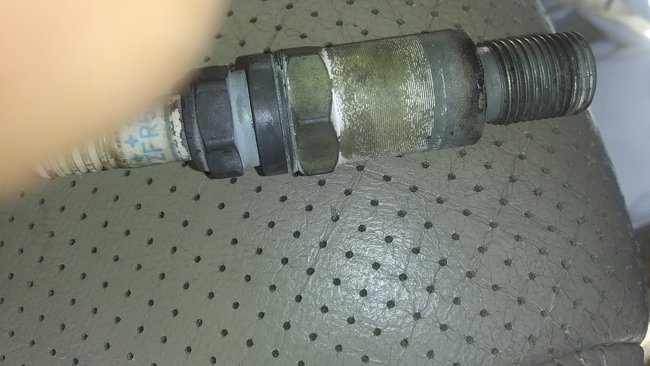

This is the adapter:
Image (Click to enlarge)

I hope you can see this.

You could try using a thread sealer on the spark plug to the adapter and let it sit for a few hours and see if it will come loose.
