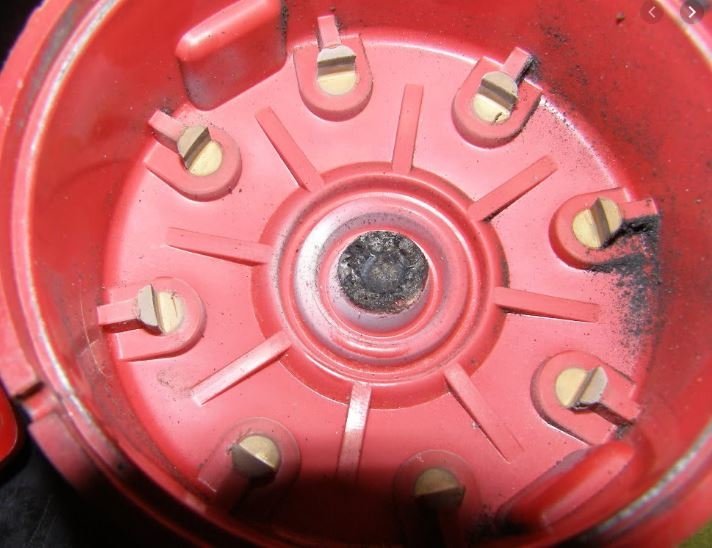

now look at the rotor button it should be facing the "mark" you put on the distributor or which ever tower you chose to be #1 (textbook or not).
the engine/ cam/ crank don't care which one it is!
as long as you were at TDC, you placed #1 spark plug wire on "that tower" (the one that rotor is pointing to)
and your 1-5-3-6-2-4 firing order starts there- and runs the sequence clockwise (looking down on the 'stributor cap)
installing it "textbook" cuts down on confusion later on, as you may have forgotten the "deal"- simply hooking it all up like it shows in the book will make it easier in 8 months! (but you gotta install it textbook now!)
