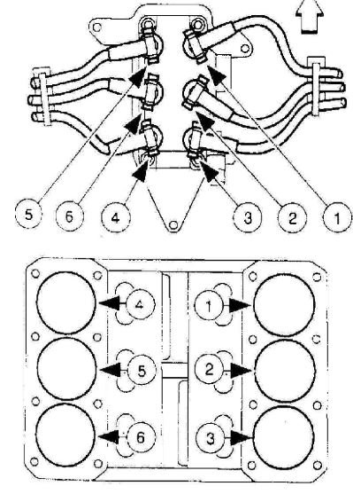

I am changing the spark plugs and wires on my SUV and I changed some not all. I only have 2 left to change and it shakes now and when I accelerate from a stop it shakes.

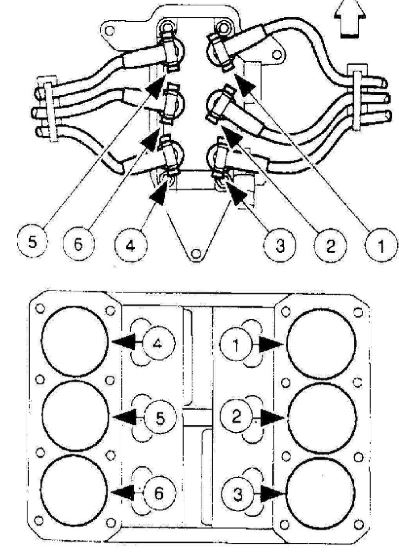

First thing to check is to make sure you didn't accidentally switch 2 wires. I have attached a diagram showing the firing order with the cylinder numbers. I hope this guides you to your solution and thank you for using 2CarPros!
