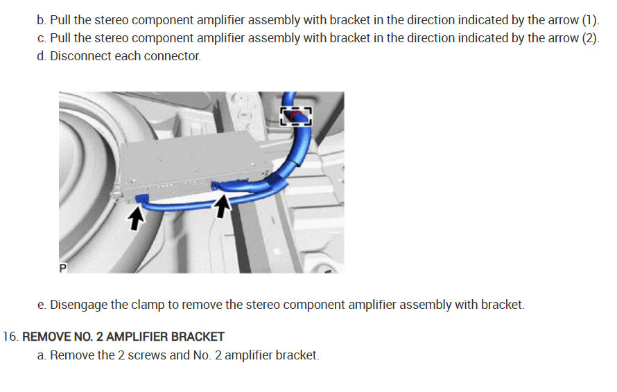

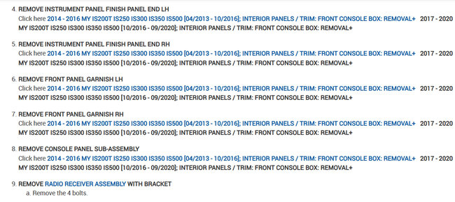

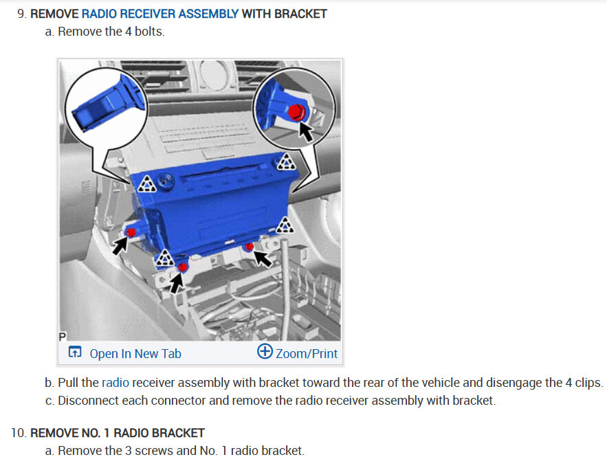

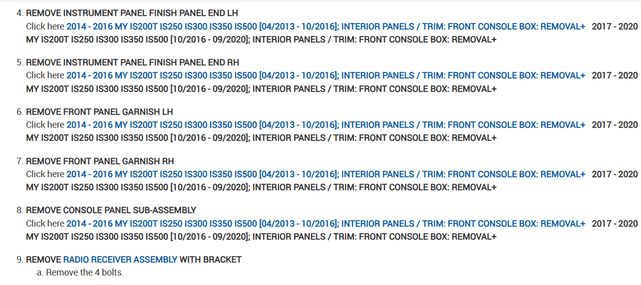

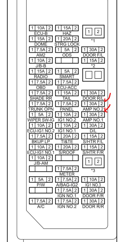

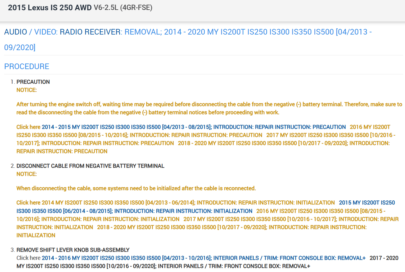

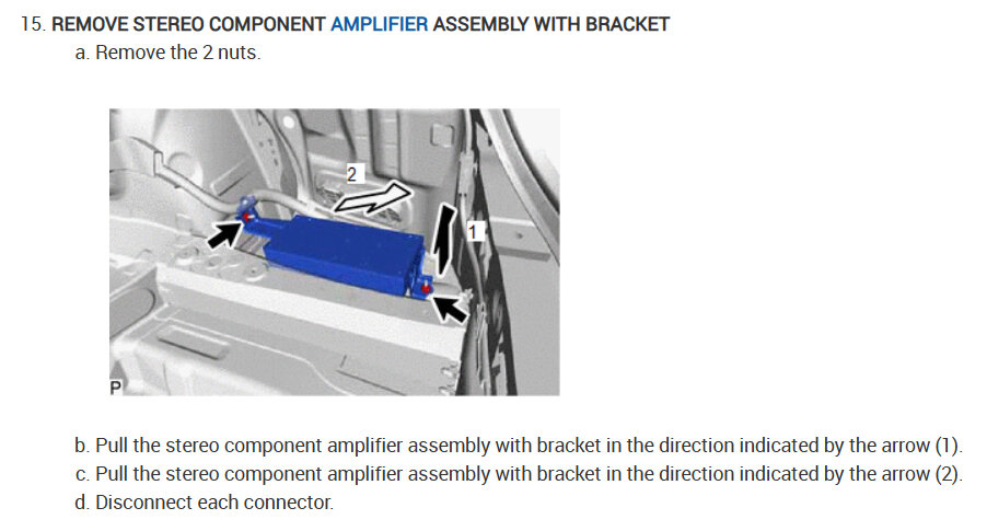

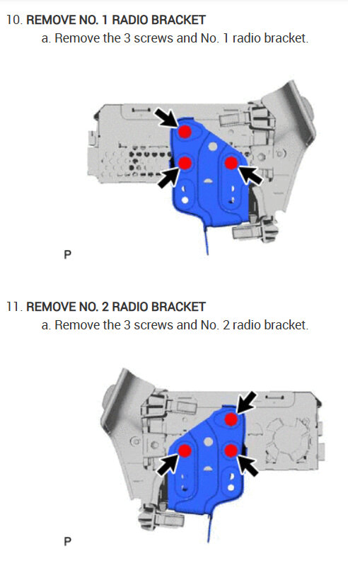

Here is how to remove the head unit and amp so they can be tested. You may want to check for water damage back by the amp while you are back there. Check the connectors for corrosion. Check out the images (below).
