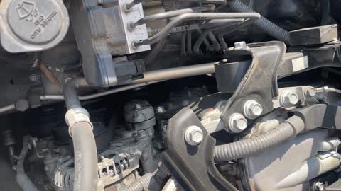

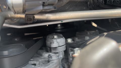

Only when ac compressor comes on there is a loud tapping/knocking sound. Oil is good, ac is super cold, am sure sound is not from the compressor. Here are 2 videos
Jul 28, 2025 at 4:07 PM
So you say you are sure it is not from the compressor? It sounds like it is making the noise which it is possible for the compressor to work but still make noise. With the engine off, grasp the AC compressor clutch and spin it by hand, it should be smooth with a slight resistance. If all is good, the problem can be the harmonic balancer or the timing chain system is worn out, ie: timing chain, guides tensioner, camshaft phasers. You might want to remove the serpentine belt to help the inspection. Check out the images (below). Let us know how it goes

I did remove the belt and the compressor turns by hand fine no problem and the AC is super cold but when I also replaced the tensioner from my wife's car same results so my question is if I remove the belt and turn the AC on will the clutch still make the same noise if it's the reason behind the noise or does it need to be turning with a belt to make that noise? How can I determine whether the noise is coming from the harmonic balancer or from the compressor
Jul 29, 2025 at 3:25 PM
The harmonic balancer will be loose at the outer ring. It might have a broken crankshaft as well. I would remove the belt and then turn on the AC to see what happens, my guess is the noise will stay the same as the load of the compressor makes the engine make the noise but you never know.

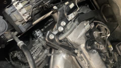

I removed the valve cover still dont see anything. Hard to move the chain around to see if any slack, any ideas on how to remove the chain metal cover? I giess i have to. And wherher i need to remove the tensioner to remove the cover, and which side is it on

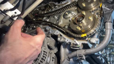

BHAMDOC1973
  • 2,008 POSTS

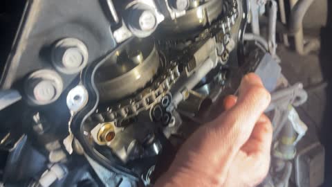

Spark plugs lugs look ok. Plz look at this chaon
Sep 1, 2025 at 12:09 PM
Yep that seems lose, I would try to look down inside the engine timing cover to check the chain further and look for broken pieces such as the tensioner or guides thank for the video, it helps. You might need to remove the timing cover completely for the inspection.
Sep 2, 2025 at 7:59 PM

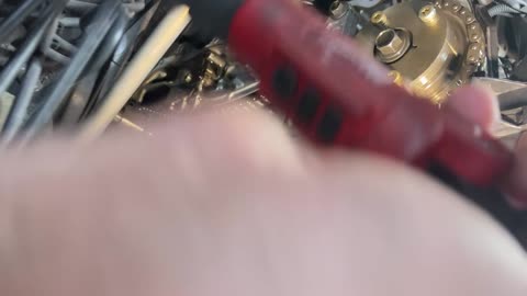

BHAMDOC1973
  • 2,008 POSTS

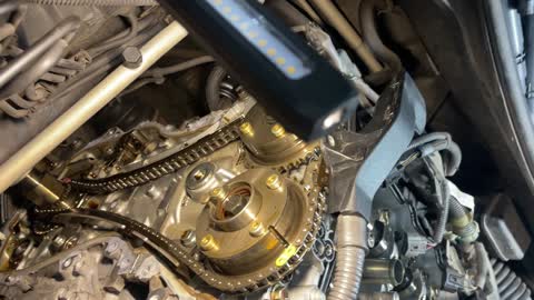

Removed it and found this plz see videos
Sep 3, 2025 at 11:13 AM
BHAMDOC1973
  • 2,008 POSTS
Not sure if this ppay is acceptable because the guide coles with just one bolt and the other side is held by the tensioner tension?
Sep 3, 2025 at 11:26 AM
BHAMDOC1973
  • 2,008 POSTS
I placed it on TDC and the top and bottom marks line up but not the chain colored ones so at least i know its in time
Sep 3, 2025 at 11:41 AM
Yep, you found the problem, the timing chain, tensioner and guides need to be replaced. They make a kit with all of these with seals to help with the repair. Nice work getting the front off of the engine so fast :) Thanks for the videos! They help.
