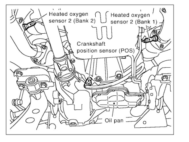

The code P0335 which is the crankshaft position sensor I would replace it first. Here is a guide and a diagrams below to show you where the sensor is which is under the car ion the transmission bell-housing:
