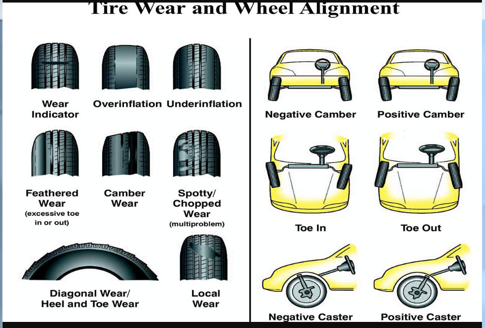

If this only happens when you are accelerating, then we need to suspect this is a tire issue or a possible runout issue.
So, let's start with this guide and the chart below to look at the tires for wear patterns. I understand that you looked for tread separation, but we need to see if they are wearing oddly.
https://www.2carpros.com/articles/how-car-tires-work
If they are then we need to address that. If not, we need to have them balanced as this sounds like a possible balance issue.
Is there a speed when this goes away? This sounds like a driveshaft issue but clearly this vehicle does not have a driveshaft, so we need to exhaust a tire issue.
Let's run through this and we can go from there.

I had my boss check it out yesterday evening as I was worried, I was going to ruin something worse. it was a tire issue; the tire was defective after about 3,000 miles it had slipped a belt (honestly not sure what that means anyway) but I got new tires today and it helped it was only one tire, but I got a whole new set and seems fine for now. if it happens again, I'll update. thank you for your time and detailed info.
