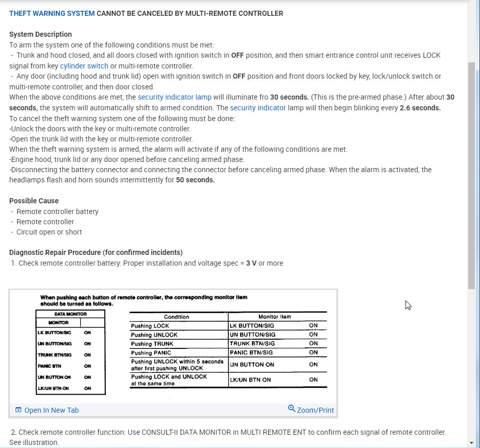

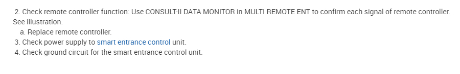

Normally this means there is an issue in the system and we should check for codes to see if there is anything that will point us in the correct direction.
I attached some testing that helps figure out what the possible cause is but we should start with checking for codes and go from there. Thanks
