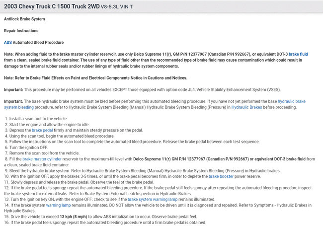

If the system drained, chances are the ABS module has air in it. What needs to be done is called an automated bleed. This is done with a scan tool capable of communicating with the ABS module. The only other thing that would cause a soft pedal would be if the rear brake shoes are out of adjustment.

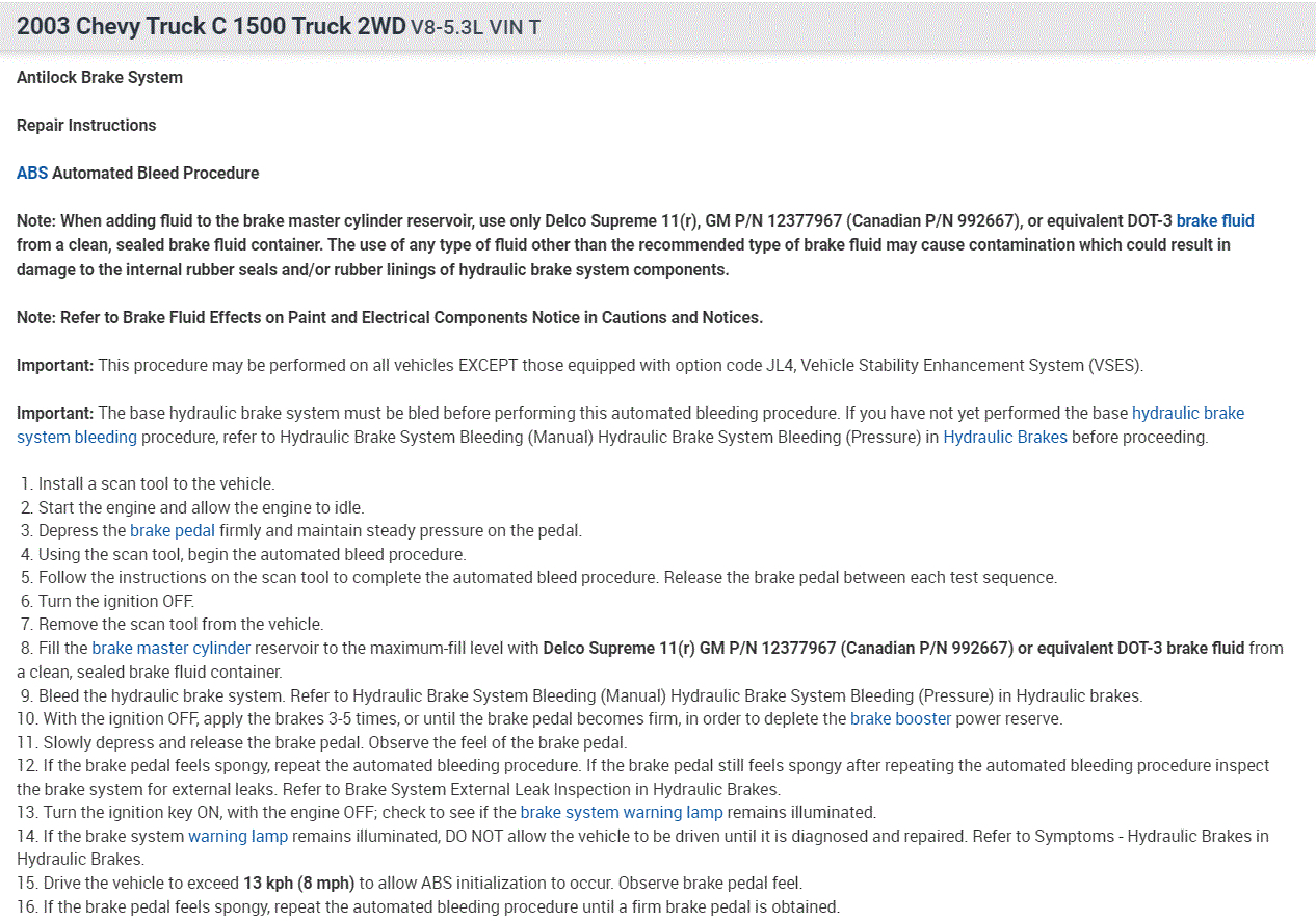

Take a look at the directions below. They include how to perform the automated bleed procedure.
If your vehicle doesn't have ABS, let me know.
I hope this helps. Let me know if you have other questions and if this takes care of the problem.
See pic below.
