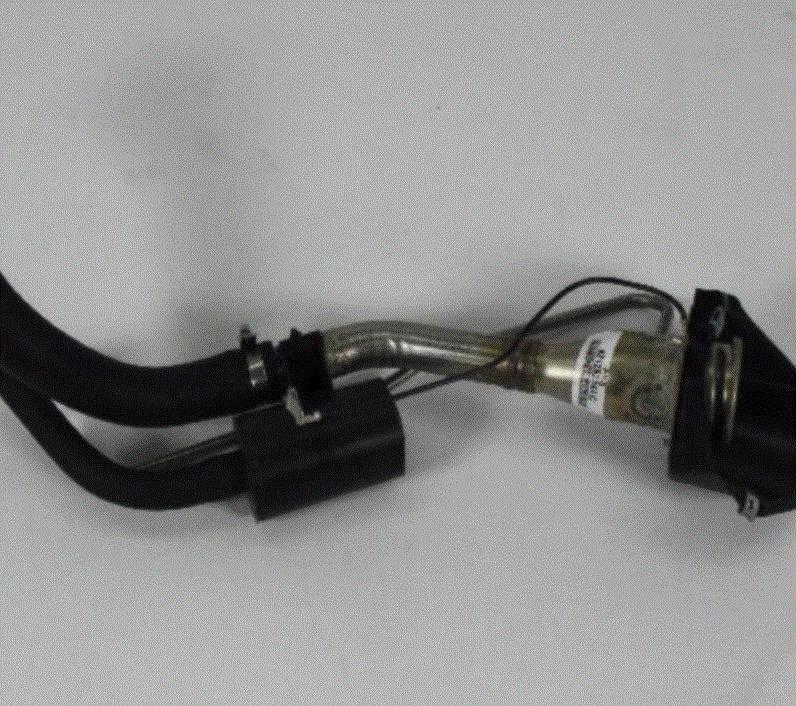

When you say filler cap, are you referring to the fuel tank filler tube? If so, inspect for small rust holes or any evidence of corrosion that could have eaten through the steel.
Also, there will be a rubber hose between the filler tube and tank, check that for leaks as well.

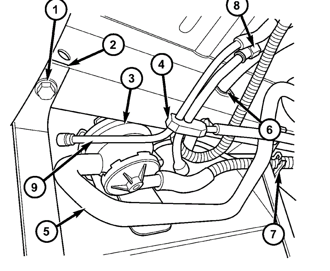

Keep in mind, there are several Evap components around the fuel tank. If possible, check from the underside of the vehicle to tell approximately where it is coming from.
I attached a pic below showing the leak detection pump toward the front of the tank and many hoses related. Any of these can be leaking.
See pics below Pic 2 shows what the filler tube looks like, so check anywhere it could rust and everything from the tank to the filler opening.
