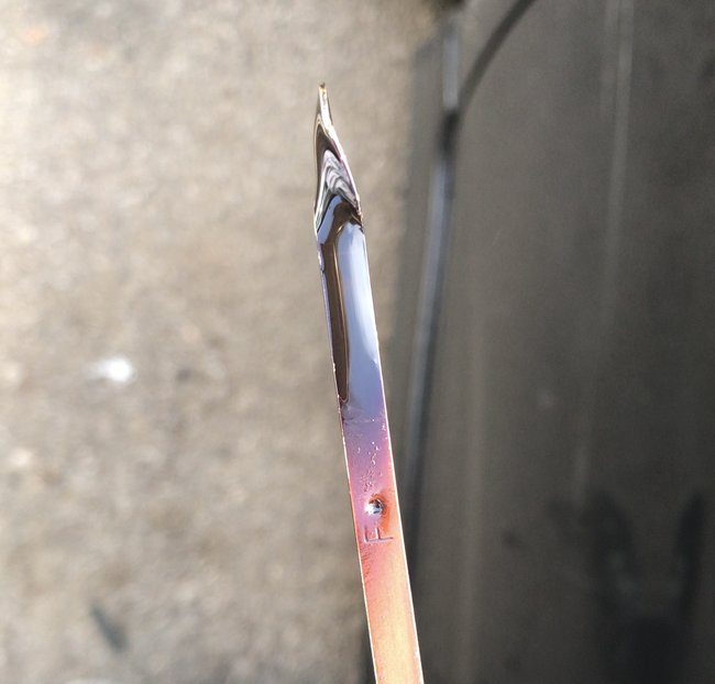

I shut it off after seeing the smoke, was afraid i might damage anything further by keeping the engine running.
That’s the color of the oil and where it’s at. No previous problem whatsover before that.

It just appears to have just little dirty oil and just a little low.
Typically is you will get white smoke if there is a leaking gasket like the intake manifold gasket or head gasket.
Check for any type of leak in the engine bay or on the ground. Check around the intake manifold where it connects to the cylinder head.
If you are not comfortable then it will be best to take it to a repair shop for evaluation.
